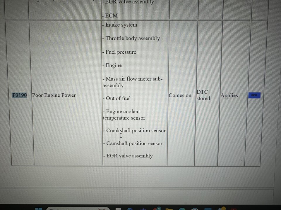

    I thought the same. Was planning on checking all possible issues as per the Prius manual. Will have some time on weekend and will update you with results. Already Intake/ Throttle/fuel pressure/ Engine/ out of fuel eliminated. Gonna focus on rest of the issues.

  14. ChapmanF
    28,721
    19,020
    One risk if the only place you look up the trouble code is in the summary table of codes like that is you just get the naked bullet list of all things that could ever have anything to do with it, and that's a lot less help than if you flip the rest of the way to the troubleshooting section for the specific code and look at the suggested troubleshooting steps there.
