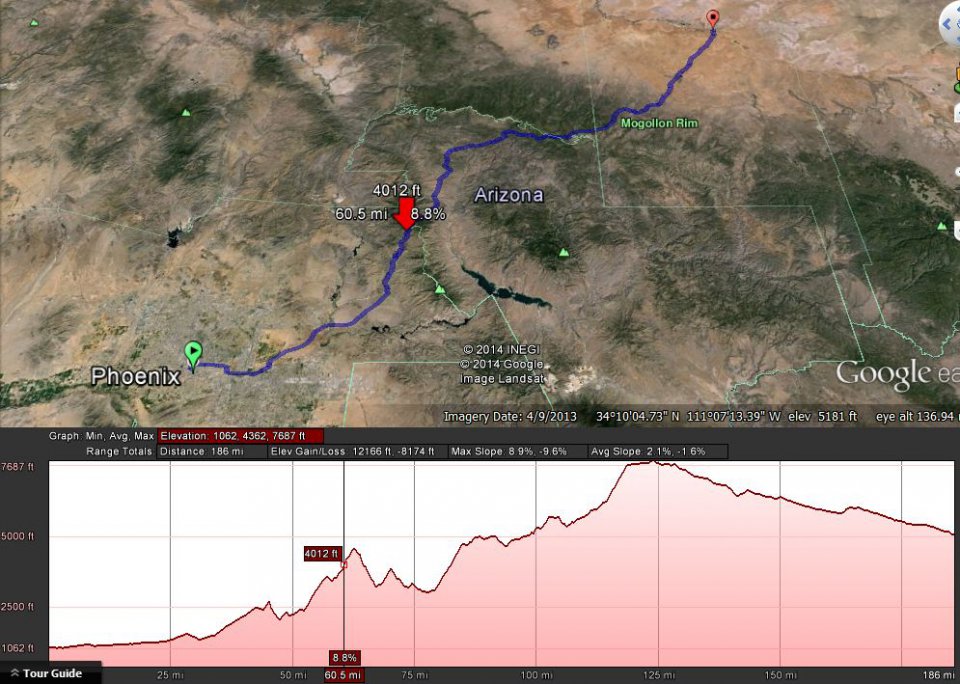

  18. miscrms
    miscrms Plug Envious Member
    Aug 21, 2007
    2,079
    527
    Phoenix, AZ
    Gen 2 can do the drive below at 70+mph without draining battery, but it does take some awareness. As I understand it the Prius controller steps the ICE rpm in discrete steps, and then varies the power/rpm of the electric motors to make finer adjustments in power to the wheels. By varying the pedal position either up or down a little you can find operating regions where it will hold speed and even accelerate up these sorts of grades without depleting the battery. If you keep the SOC on the battery high you will even have plenty of power to accelerate back up to speed when slowed by trucks or other slow moving vehicles in the left lane. If you don't keep an eye on things you can get into a very low SOC region on the battery that forces power to be diverted to bring the battery SOC up fairly aggressively, resulting in the kind of under-powered behavior noted. I would certainly expect the Gen 3 with its increased power and next gen electronics to do an even better job in these challenging conditions.
  19. miscrms
    Aug 21, 2007
    2,079
    527
    Phoenix, AZ
    Playing with some numbers on evcalc, the 76 hp ICE in the Gen 2 should be able to maintain about 75mph on a 7% grade with no power in or out of the battery. At 98hp the Gen 3 ICE should be able to maintain 85+ mph on the same grade without power in or out of the battery.
