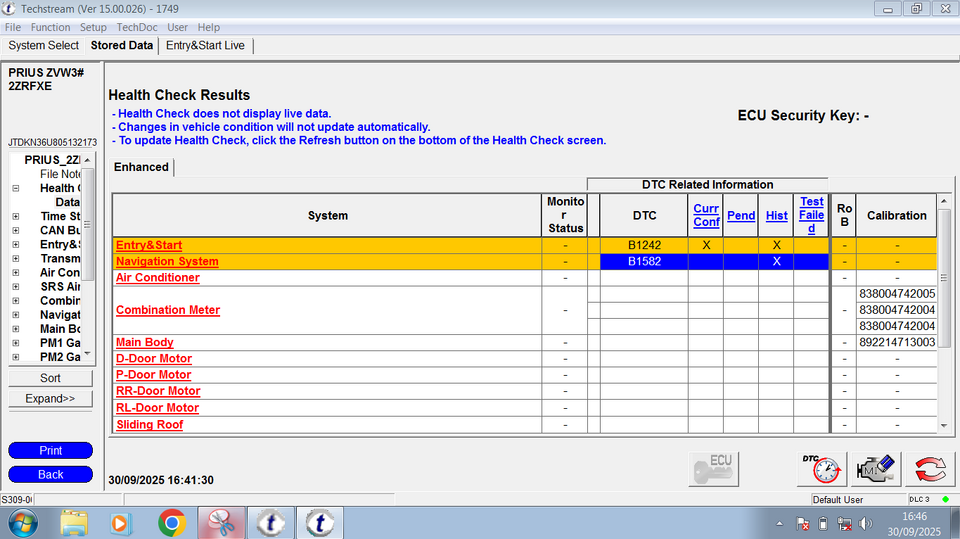

    I have a Prius Gen 3 2010 with the Key not detected issue, I only have one key fob, I have changed the fob battery and the 12v accessory battery, the car does not detect the key fob and I have to hold the key to the start button to start the car, every now and then the car will randomly detect the key fob for a short while and then go back to key not detected, I thought it could be a faulty key fob so got a mobile car locksmith technician to come and register a new key fob, he programmed the new fob but could not get it to be picked up by the SKS system he had to hold that Fob to the start button as well, he said that his scan tool told him that there was a fault on the car itself?

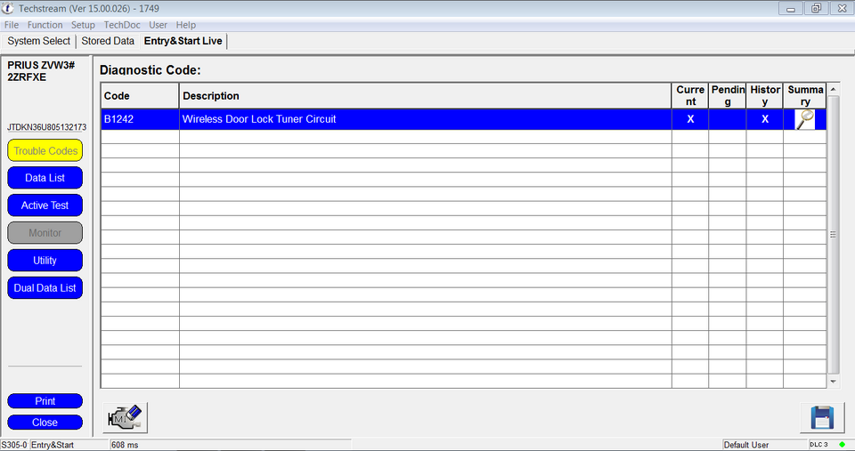

    I bought a Techstream interface online that came with Techstream 15 and I successfully connected to the Prius and used the health check utility to scan all of the ECUs, it came back with DTC (B1242 Wireless Doorlock Tuner circuit) and also a DTC for the Nav as well (photo attached), I cleared the codes but the DTC B1242 came back within a few seconds so its picking up a fault somewhere but the Techstream software is not telling me exactly where the fault is which I had hope that it would do and the only reason I bought the interface.?

    Yes the fault never goes away though its been the best part of a year that it has not been working properly, the Techstream interface gave me the code for the problem as B1242 so for me its an actual fault on the vehicle.

    Do you also get the B1242 code on Techstream?
