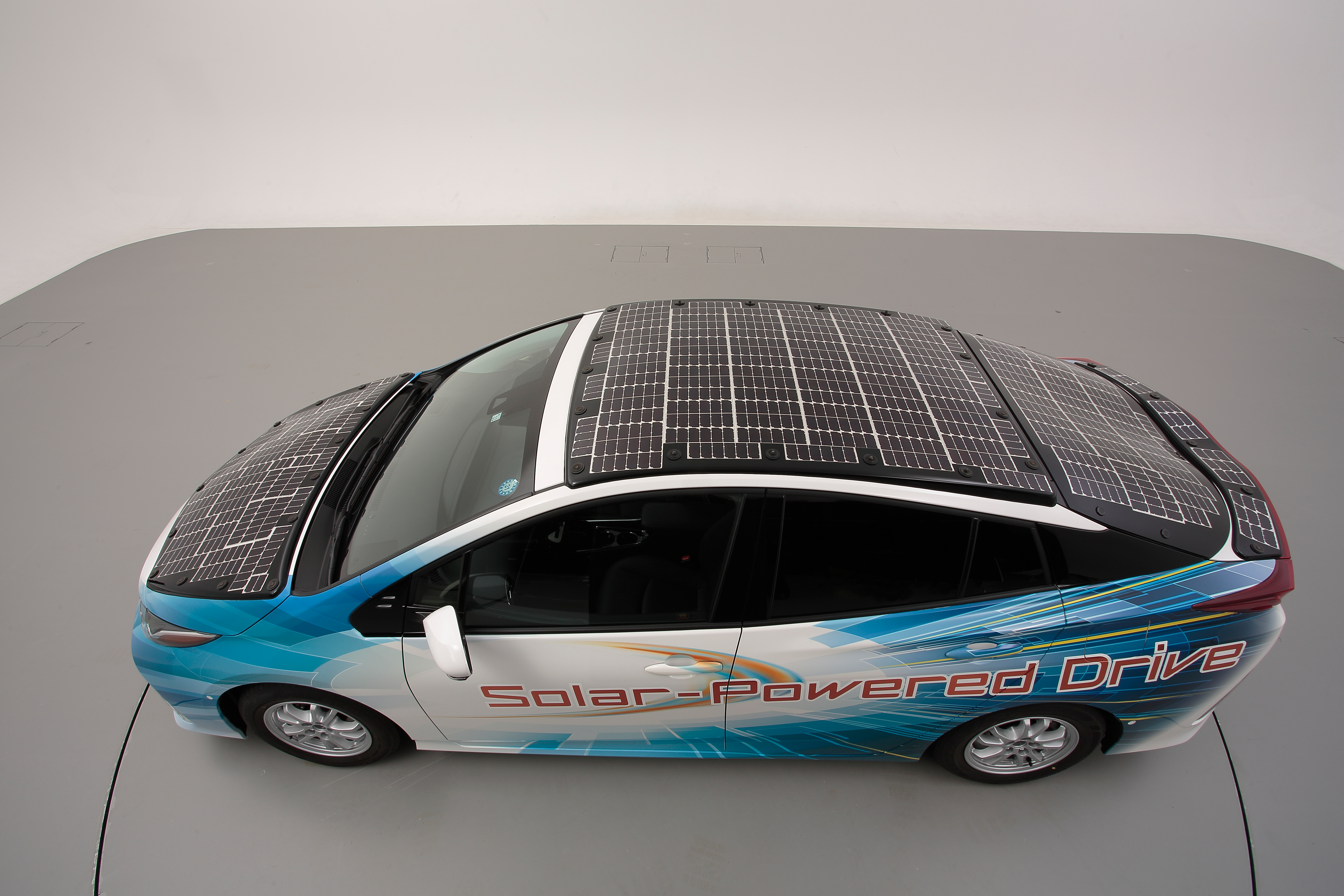

    I've had my outdoor solar panels for a year, so I know here I average 3.5 kwh a day for each kw of solar panel I've got up, some days I get 6 kwh some I get close to nothing. Many places are not as sunny, and some are more sunny.
    The prius prime in japan had an expensive 180 watt solar roof. If you pretend that I parked in a sunny place like my solar roof all the time, not in parking garages and in my garage, etc, you would expect to average about 0.6 kwh a day. Even at $0.15/kwh (I get $0.093/kwh off my utility bill) that's only $350 worth of electricity in 10 years.
    So you need to make it bigger to make any sense at all
    Toyota is testing a much more efficient solar roof for its electric cars - The Verge
    Now we are talking on much more expensive panels and we get to 0.86 KW of panel. Make sure not to crash as insurance is going to be expensive. Now we are talking about $1650 worth of $0.15/kwh electricity over 10 years if you are very carefull to park it outside in without buildings or trees shading it, and in the right direction. My guess is it would cost toyota at least $3K to do this and it to pass crash tests with today's technology. Or you could add an extra 3 kwh of batteries to the phev (toyota's cost is probably $500) and the driver could use it whenever they wanted the extra range without worrying about parking etc.
    Well the cyber truck is stainless steel, with flat plates, and larger. They are talking about it possibly adding 15 miles of range I'm guessing that is 1.5 kw of panels, something you can't physically fit on a prius even with the most expensive cells. Additionally my guess is they wouldn't have to modify things to pass crash tests. Still the money will never work out but on an expensive truck some people will think its cool and pay extra. I mean some people paid for the solar roof on the prius and prime.
