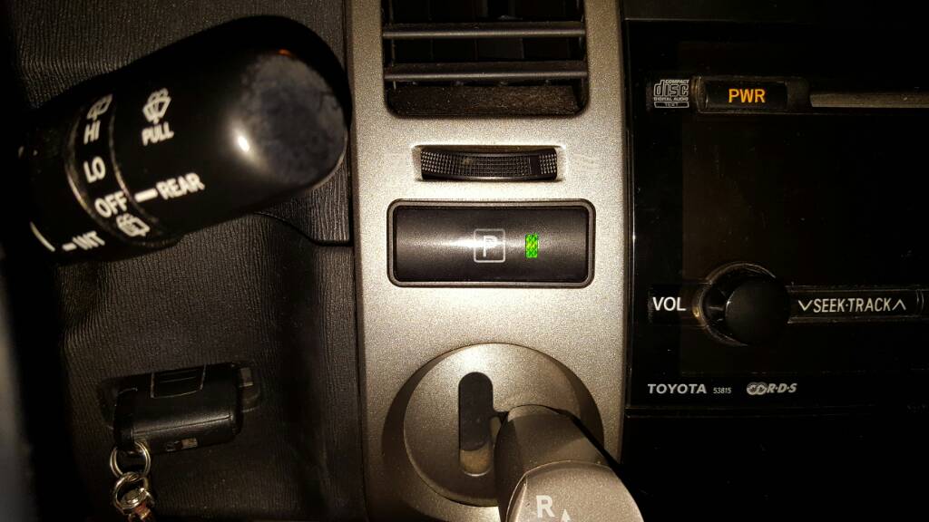

    Engine is working but not charge the car (it charging in drive or reverse mode, but not in parking (or neutral, but that is normal)
    The parking button is pressed and car is actually in parking (and ready):

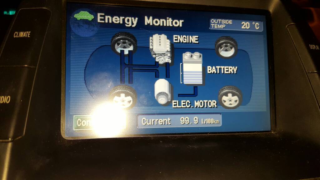

    This is the diagnostic:
    1. Does someone experience such issue?
    2. Any thoughts or info about this indications?

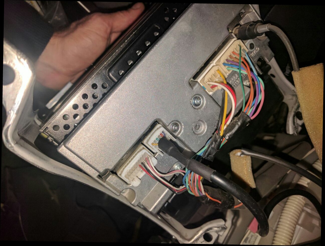

    what wires did you tap into?

    The black wire in here:

    not really. i think we need to know what those wires are connected to. try removing everything and see if it goes back to normal.
