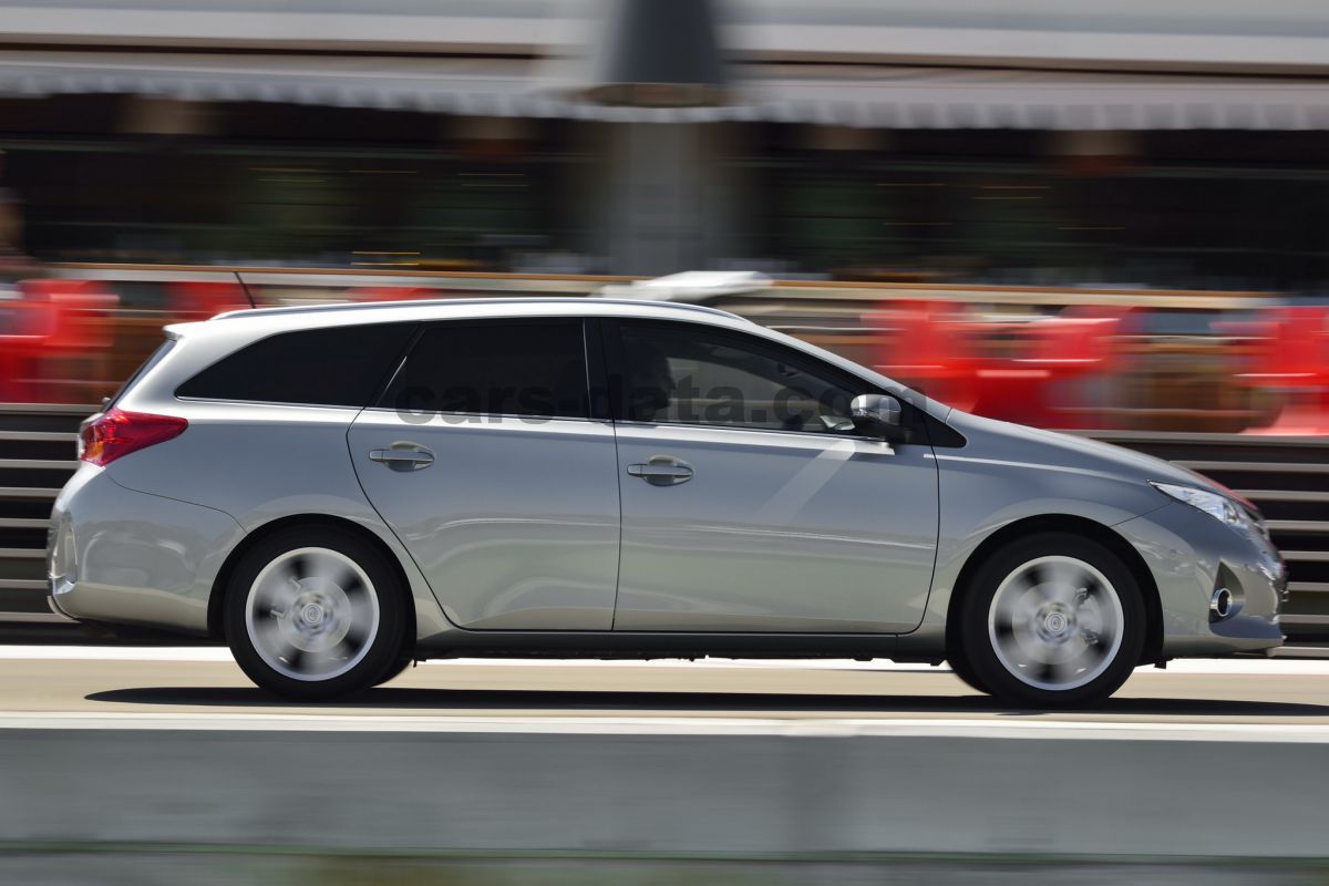

    I want to buy a new car and my options are an Auris Touring Sports Hybrid(2017) or Prius Gen4.
    Since i live in Europe and in my country Prius Plug-in is not avaible i have the two option above.
    The price difference between the two is around 9000 Euros. The Auris has also a 1.8L (136hp combined) motor and my guess is that is based on Gen3 (correct me if i`m wrong), and the consumption is bigger than Pri with 0.9 from official documents.
    Auris is pretty well equipped but it missed some features that Prius have, like blind-spot monitoring and adaptive cruise control but that will save me some money .
    Since space is a big problem for me, and i think in the future i will have a child i am considering the Auris TS.
    Anyone knows the differences between the two? Any advice?

    He means Auris TS - Touring sports it's estate version of your Corolla:
