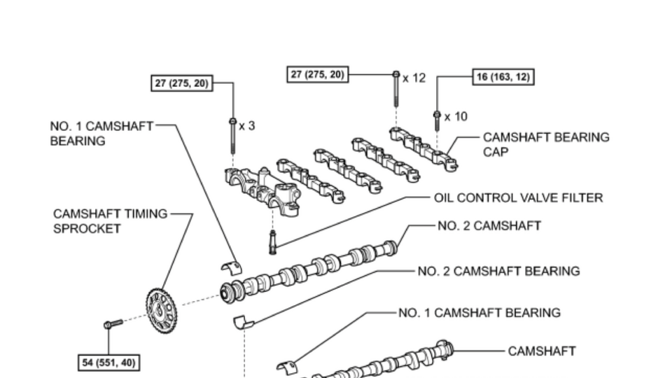

    What torque value? Screen grab from last link in my signature*:

    did you note in pic I posted above, there’s 20 and 12 foot-pound values? Thelong versus short apparently. You’re more familiar than me, having dealt with these; I’d gather the two kinds of bolts serve different purposes?
