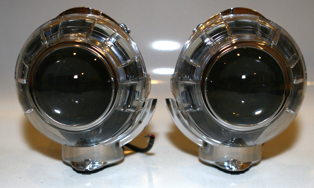

    Here's a photo of the LS460's I'll attempt to slap into the Prius headlight...
    And if I'm really daring, slap in the LS600hL triple-LED-projector! Only downside is that I will be losing my highbeams. But, I may be able to retrofit the mini-h1 projectors into the fog lights and use those for fog/High-beam units...

    Those may not fit!!! Do you know the size from top to bottom. The FX-R right now are a tight fit with the E46 shroud.
