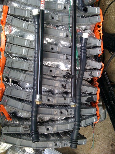

    Those were posted originally in a thread on a DIY plugin mod for a Gen 2 with two extra battery assemblies in the trunk, and insufficient control over charging. The first picture is on page 9 of the thread and taken in early March 2009. It was initially explained away as the fault of the pack that had failed, having been bought secondhand after possible flooding, which the owner assumed may have internally shorted two modules (perhaps not realizing the modules are sealed).
    The next pack to fail went in late June of the same year; that's the second picture, from page 17 of the thread. At that time, the owner got checked out in a hospital, having inhaled a snootful of KOH as aerosol or vapor.
    -Chap
