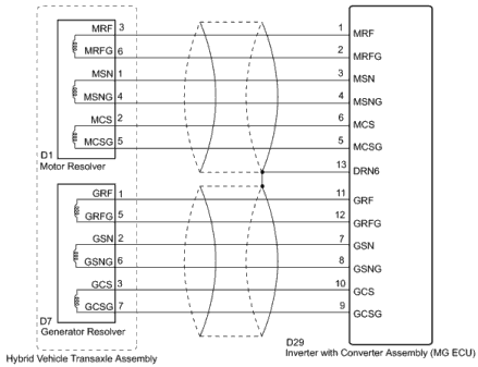

    Be guided by which codes you have. The most pressing is by far the P0A4B because you can't even crank the engine with MG1 out of the game, so focus is what you need for now.
    Flip to page 40 in this attachment and read the first few pages for a start. Now you know what this code is telling you about. Notice under WIRING DIAGRAM it says to refer to the earlier P0A1A-200 section ... which is outside of that small attachment I linked. If you look for the complete repair manual (bigger file....) it's in there.
    For convenience, here's that diagram:
    The code is about the generator resolver, so the connectors of interest are D7 and D29, which look like this:
    D7 is high up on the tranny:
    D29 plugs in at the inboard front of the inverter. It isn't orange, meaning it's officially low-voltage, but you still glove up, pull the orange service plug in back, and wait 10 minutes before working on it.
    I'm expecting (because P0A4B is an interphase short) that you may discover some wire damage bridging between GSN and GCS, though possibly they consider the excitation field a 'phase' too. Whatever, it's only six wires to check, and I won't be surprised if you spot the problem without a meter.
