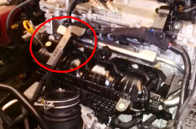

    Very intresting topic! I've been trying to get the intake manifold out for inspection (my 2010 is at 75000 miles), however I ran into 1 (probably) little hurdle that I cannot seem to take. On the intake manifold there (from the middle its located a little to the left)is a connection point where a bundle of electrical wires is secured to the manifold through some plastic fastener. I must have overlooked something, but I couldn't find a way to get that bundle of electrical wires disconnected from the intake manifold? What way is there to get this done?

    61,511
    42,324
    Think I know what you mean, regarding the plastic coupling, and it blocking access to pipe flange bolt, at the intake mainifold end? I've got it off, it's doable, but it is royal, back-breaking pain, with very little clearance. Persevere, it can be done.

  19. Goneflying
    Goneflying Junior Member
    Feb 21, 2014
    Netherlands
    I found a picture and circled what I meant. I think you were thinking about the same. It doesn't have a fastener or bolt I've seen in other parts in this car. I'm just not sure where to start and with what tool. How did you get it off?
  20. Mendel Leisk
    61,511
    42,324
    Sorry, the connection I'm thinking of is in bottom-right corner of that pic. Another pain.
