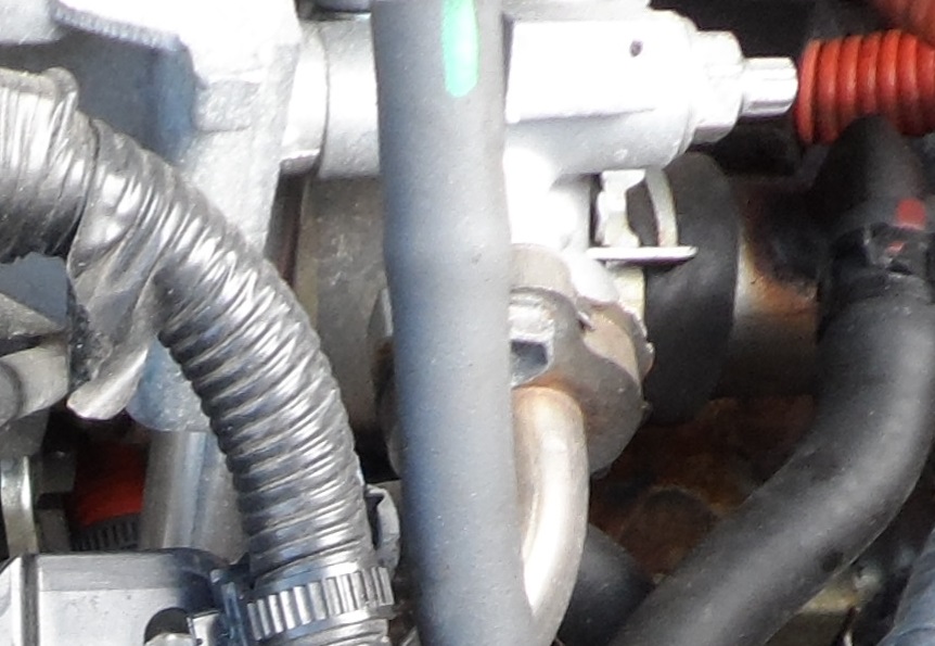

  2. DG Bear
    DG Bear Junior Member
    Jun 7, 2014
    85
    24
    plano, tx

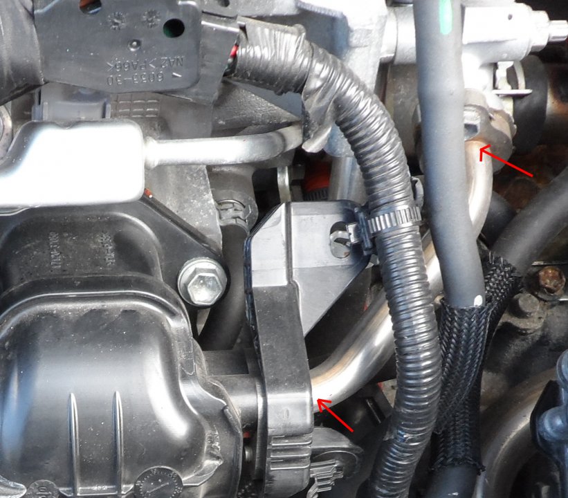

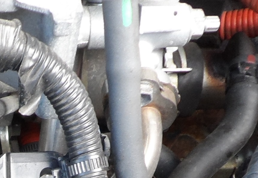

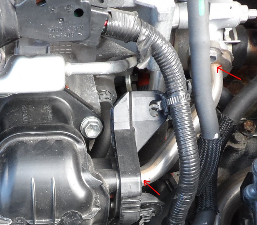

    It's a plastic (or nylon) wire retainer type clip... but it's a pain to get to it.
    You have to pinch the retainer from the rear and it latches from left to right. I used right angle pliers to pinch it while using a flat screw driver to place upward pressure on the clip. (Seems like a door panel trim removal tool would have been easier than the screw driver.)
    Be patient and keep working it... it will come.
    Did you just remove the EGR pipe or did you remove the entire intake manifold and throttle body out of the car?
    There is a real problem inside the intake manifold and you have to remove it to clean it...

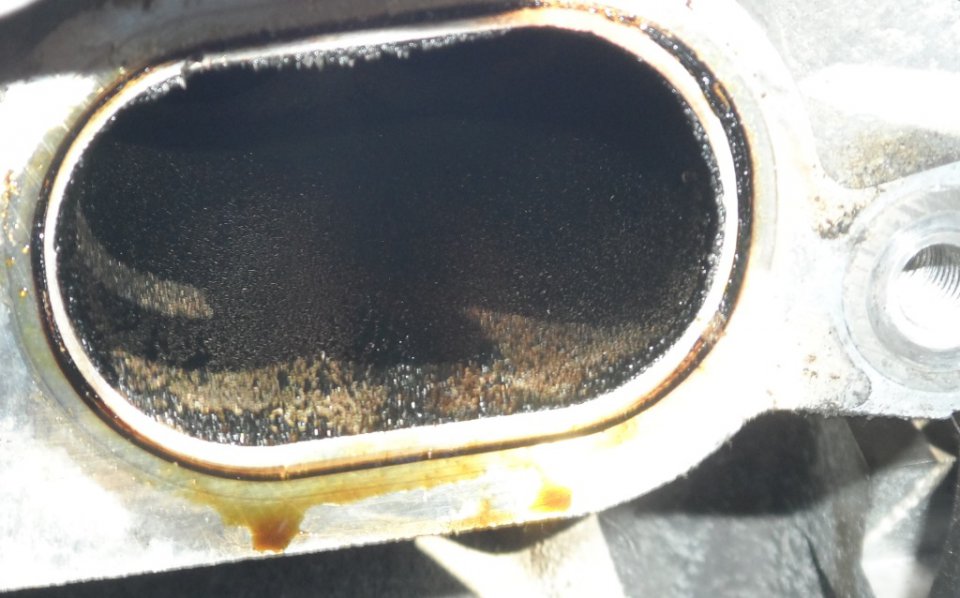

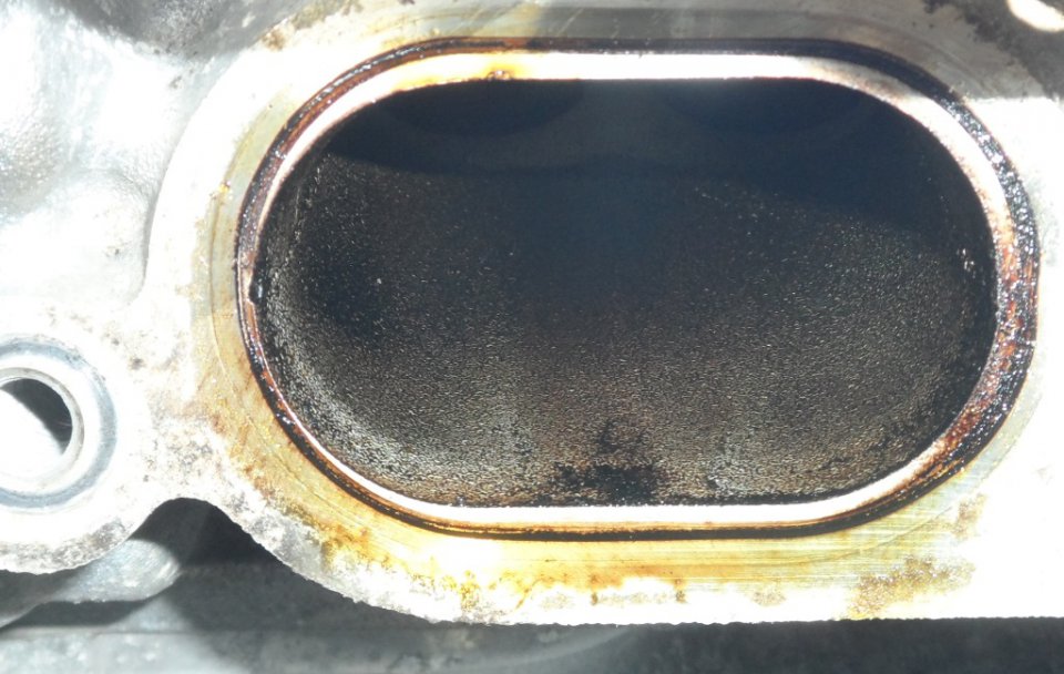

  3. Umar Ali
    Umar Ali Member
    Aug 23, 2013
    274
    91
    Dallas, TX

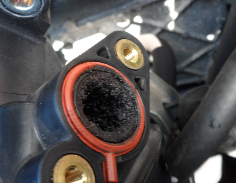

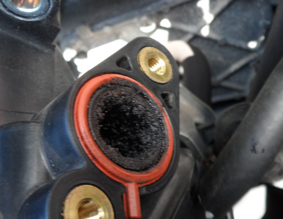

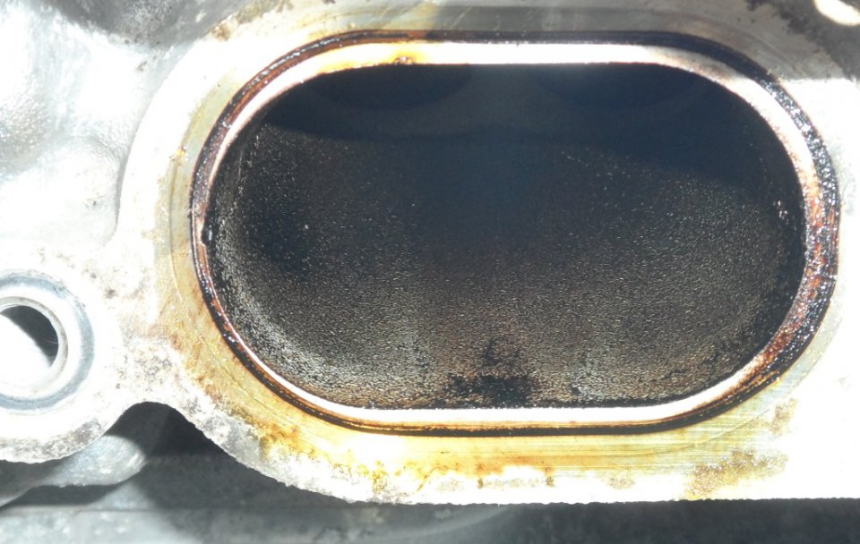

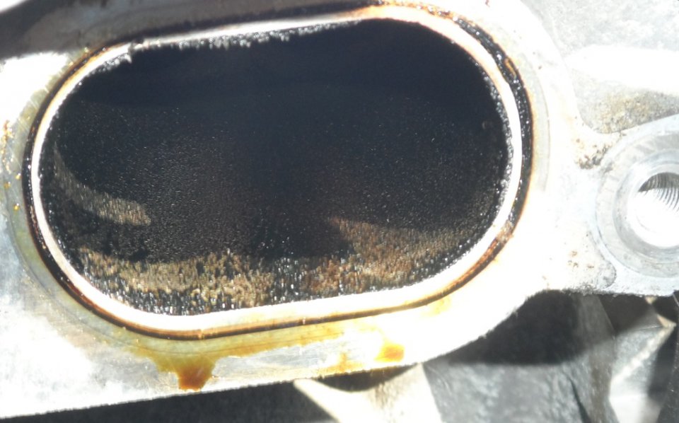

    so i took apart everything and found carbon deposit of bad kind. now what should i use to clean it up, it is not greasy carbon it is rigid solid deposits.
    [​IMG][/url] [​IMG] [​IMG] [​IMG] [​IMG] [​IMG] [​IMG] [​IMG] [​IMG] [​IMG] [​IMG] [​IMG] [​IMG] [​IMG] [​IMG] [​IMG] [​IMG] [​IMG] [​IMG][/IMG]
    now i need to know what should i use to clean this?. i bought throttle body cleaner from autozone but it mentioned that it may damage the plastic or painted surfaces. now the manifold is all plastic so i am hesitant to use it on that. what should i use instead? any suggestions?.
  4. DG Bear
    Jun 7, 2014
    85
    24
    plano, tx
    Could use the throttle body cleaner just don't get it on your car's painted surfaces. You could also use gasoline.
    Actually yours does not look that bad... the small holes still look open. Was you car having problems?

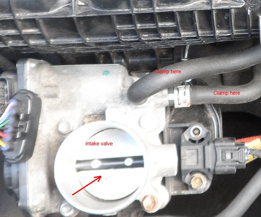

  8. Vyse
    Vyse Junior Member
    Feb 16, 2015
    Hi there,

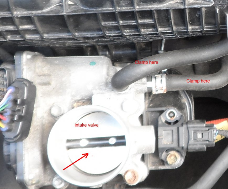

    I was wondering what kind ot "clamp" did you use to prevent coolant to flow when removing the intake manifold ? Also, don't you need to drain the coolant as there might be some air inside the cooling system ?

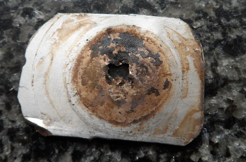

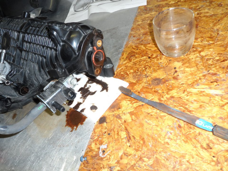

  9. Kortenbach
    Kortenbach Junior Member
    Jun 10, 2013
    24
    Hi all,
    I am the creator of this thread. I'm happy to see that so many people find this usefull!

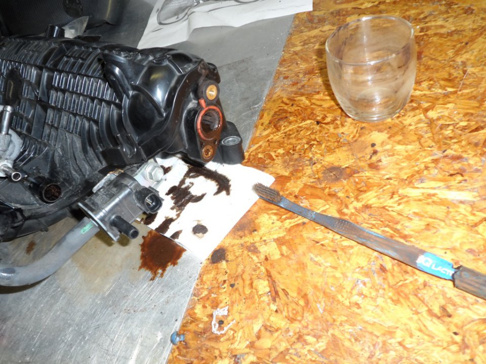

    @Vyse: I used woodworking wood-clamps. If you clamp the hose before taking it off you should be fine.
    I did some 20000 miles now without the problem recurring.
    I didn't mention this before but the carbon deposits from the EGR where oily in my car. How about the others? I cannot say my car uses a lot of oil. I never had to refill between oil changes...

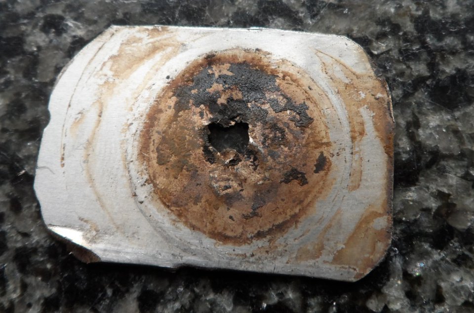

    Did anyone find that the EGR was blocked on purpose by adding a gasget (as shown in the first post)? By the dealer?
    Best regards,
    Bert Kortenbach

  10. m.wynn
    m.wynn Senior Member
    Oct 24, 2013
    684
    1,230
    Queensbury, NY
    Thanks for checking in, Bert. Like you, I'm at ~20k miles since cleaning up the intake manifold and egr pipe and the car is still running well. Yes, the carbon deposits were "oily" and my 2010 uses zero oil. No doubt it's fuel or fuel vapor creating the sticky consistency of the carbon build-up. It's messy stuff to work with.
    EGR was not blocked. Did you have check engine light/P0401 when your EGR was hack blocked?
    Kortenbach likes this.
  11. Kortenbach
    Jun 10, 2013
    24
    @m.wynn:You can find most details in the first post of thjs thread. No engine light and no ODB codes. The car thought is was doing great while in fact it was pretty ill ;).
    I doubt it is fuel that creates the stickyness. Fuel has a distinct smell and would evaporate pretty quick. I think it is oil, but I have no idea where it is coming from. The stickyness stopped where the stainless ERG pipe connects to the intake manifold. Inside the stainless EGR pipe there was only very limited carbon buildup. It did not need any cleaning.
    Happy tinkering !
    Bert

    @DG Bear: As stated in my first post there was quite a bit of oil in there (check DG Bear's video). I thought that would be normal, but in your video there was no oil!? Maybe in Holland (that's where I live) gasoline contains more oil. That might account for the oily gunk buildup in the EGR return channel. Maybe this is a regional thing? I imagine that the oil runs back to the throttle body after the gasoline is injected into the inlet manifolt. Or am I talking bullshit now?

  13. m.wynn
    Oct 24, 2013
    684
    1,230
    Queensbury, NY
    A poster in this or one of the other IM cleaning threads stated that he left the coolant hoses connected to the TB, simply unbolting the TB and letting it hang by the hoses, thus not losing any coolant. To do over again, I'd just do this. Clamping off the lines is certainly an option, too, if you want to bring the TB to the bench to give it a proper scrubbing. I didn't, and the amount of coolant lost is minimal. I had to add maybe an ounce or 2 and I simply burped the lower hose a few times with the car at operating temp. It seemed to me that the burping didn't even seem to displace any air... A full coolant drain/refill is not in any way needed here.

  18. bwilson4web
    29,082
    16,528
    I think we have a solution:
    It turns out that disabling diesel EGR in cool weather is a common technique in the EU diesels:
    I speculate that a prior owner thought this diesel technique would work with the Prius. We don't know what the original blocking plate looked like but it may have also had a small hole to reduce the flow. The EGR gas and pressure further opened the hole but the low flow rates led to the coked up EGR and tube. Who did it is an open question.
    If it were a common practice at the dealer, there should be more. At one time, I would have been skeptical of a rogue dealer but VW punctured that trust. However, there is another report that in the UK some independent shops have been opening a hole in the particle filter canister, removing the filter, and closing it up again. So putting a block on the EGR may be a common, independent shop technique like gutting the particle filter trap to improve diesel performance and reduce maintenance costs.
    We know in the USA the "rolling coal" owners seek out a software patch that allows them to create huge clouds of soot. It is entirely possible that a similar practice, not for clouds of soot, exists in Europe to improve diesel performance. An EGR blocking plate and gutting the particle filter would be low-tech and easily avoid detection in the past.
    I am beginning to think portable, non-contact, emissions testing is the way to go. Today, they are established by the side of the road. In the future, they need to be on the front of public service vehicles with a license camera.
