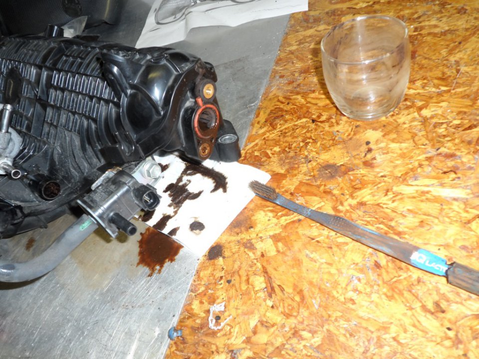

    Copied and pasted from another thread - hope this helps:
    My approach to the intake manifold was treating it like washing dishes. This took about an hour:
    1. I filled a large size container with hot water and dish detergent.
    2. Dunked and drained the manifold several times in the hot solution.
    3. Drain the manifold.
    4. Scrubbed the insides of the manifold with nylon pipe cleaners. Nylon so that you don't score the plastic. The sludge and varnish sticks to everything and must be dissolved by the cleaner to completely remove.
    5. Spray through all the openings with clean water.
    6. Repeated steps 2-5 until it looks like a new part.

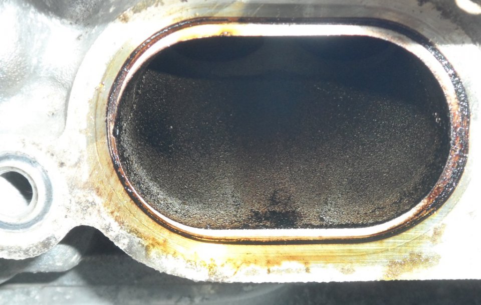

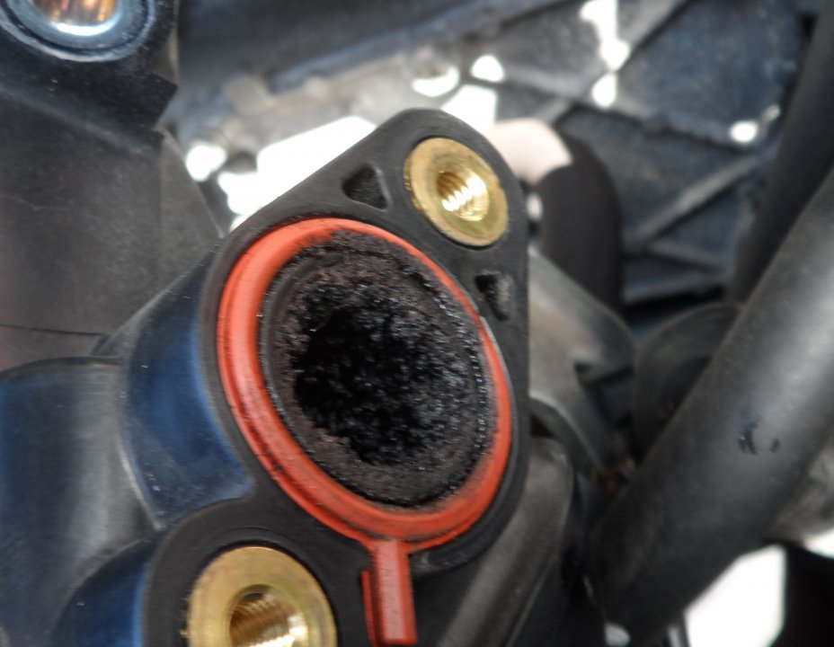

    I have a Prius 2010, Gen III. It has burned oil since about 65,000 miles (about 1 quart for every 1,400 miles). Likely due to sticking piston ring(s) and very low viscosity 0W-20 oil . I received a P0401 EGR engine fault code at about 162,000 miles. When I replaced the EGR valve I found that the EGR pipe on the intake manifold side was almost blocked solid by oily sludge. The port into the intake manifold also had lots of oily sludge. For sure it is unburned oil condensing out of the exhaust gases. The exhaust gas cooler on the upstream side of the EGR valve was also pretty clogged with soot. My understanding is that Toyota changed the 2010 and on Prius ring/piston design due to issues like this but refused to fix anything unless the car burns more that 1 quart of oil for every 1,200 miles (in the USA).
