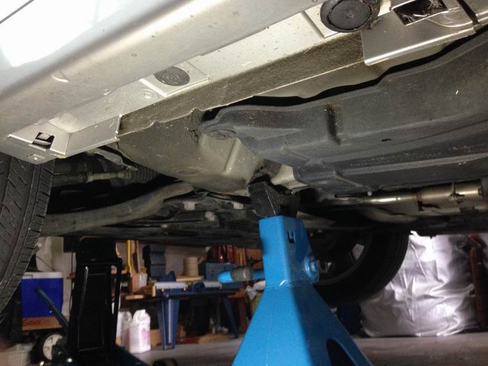

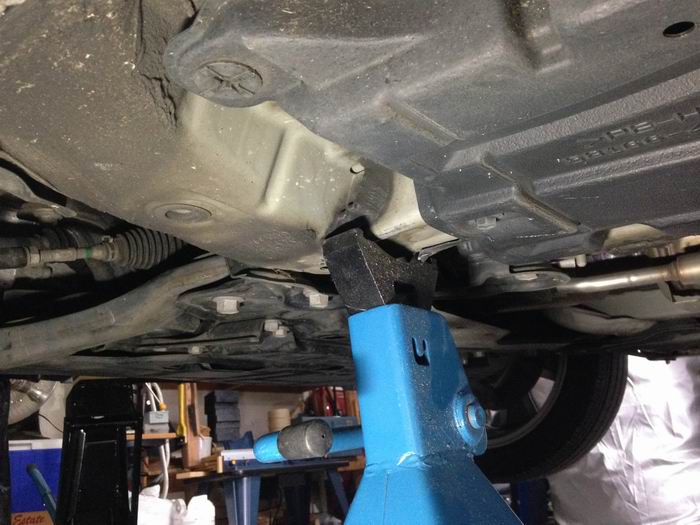

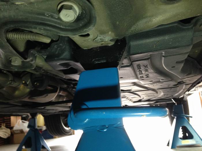

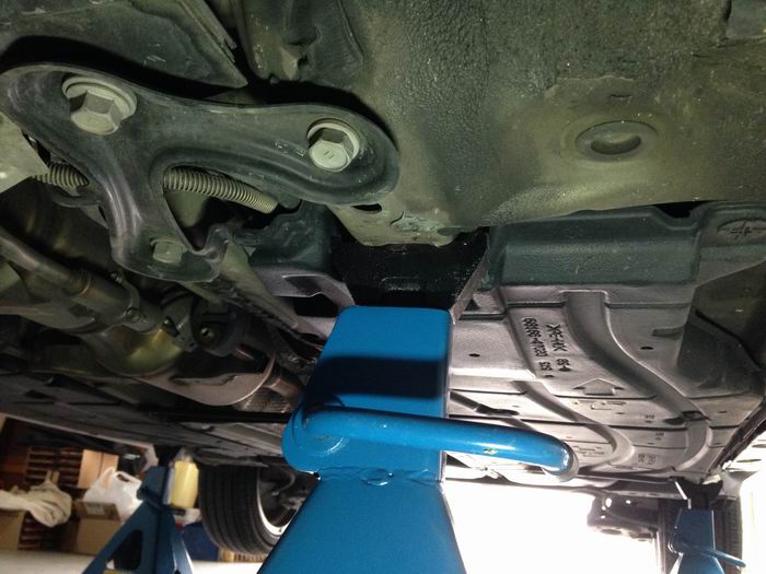

    These pictures are 3rd gen, but second gen underbody I believe is very similar. I don't like the way the front end of the car sits on jack stands, using the crimped lower edge.
    Someone here (Hobbit?) has a how-to oil change page, showing these jack locations. I've adopted the same, finding it much more solid/stable. For the rear, I do go with the crimped edge, the weight is a lot less. Anyway:

    I guess I'm not too crazy about balancing the front end of the car on one jack stand. Different definition of stable, I guess.
    I'll continue to use the jack points on the pinch flanges.
    [The OP has responded that he's using two supports in the front--they're just not visible in the pictures he showed]

  3. Mendel Leisk
    61,533
    42,345
    I am using two points at the front, LOL. They're just inward a bit.

    It does look like a suitable point, but be sure to check the area for signs of bending or deformation following the procedure.
    Anything to report? No damage or sign of impending failure in the area? ;)

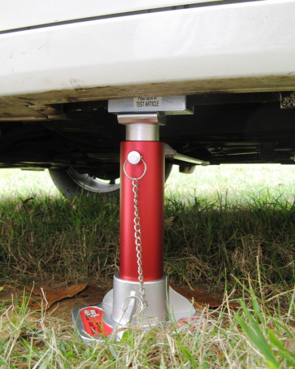

    Likewise, I would prefer to jack up the car only on the Toyota "approved" points, meaning the front and back center points and the four pinch weld points on the rockers.
    While the jacking points that the OP appear to be stable, those places are not designed or intended as supporting places for the corner weight of the car, and may be bent or deformed.

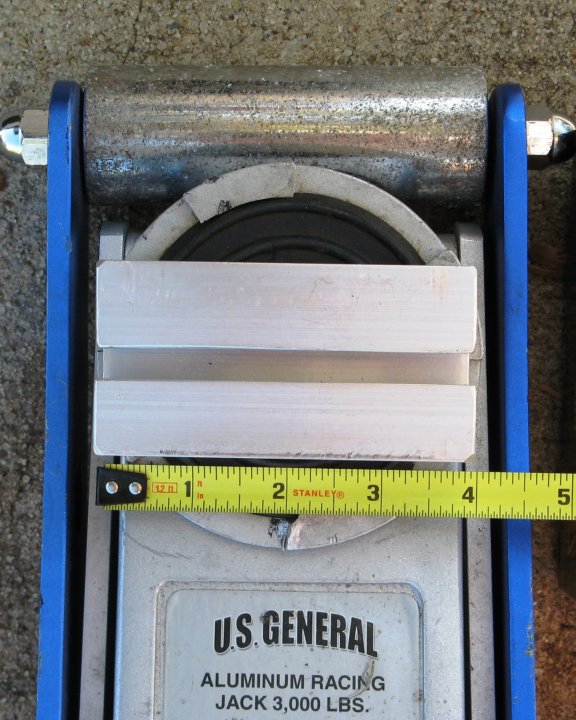

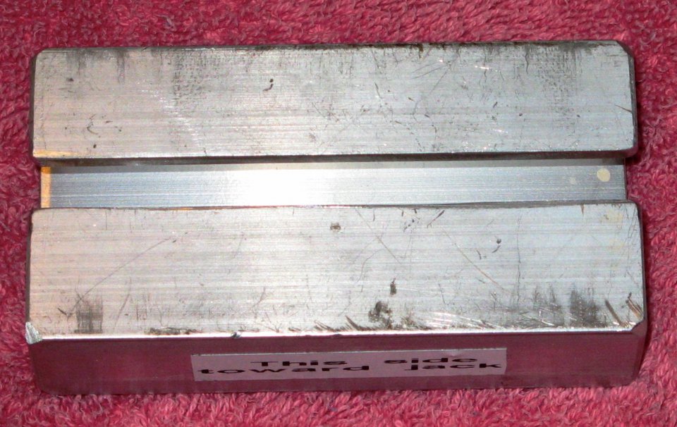

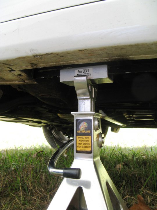

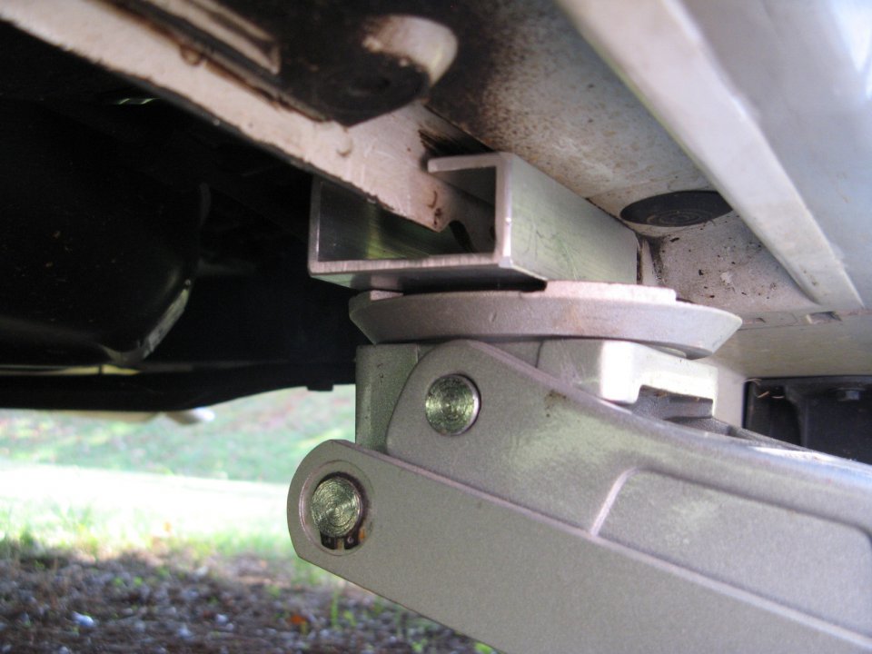

    I proposed a jacking adapter that is designed for the "flat top" aluminum racing jack widely sold by Harbor Freight and others. It would also serve well for jackstands. It distributes the weight of the corner of the car to a wide area both inside and outside the pinch weld. It bends to react to the weight of the car. The pinch weld will also settle on the bottom of the adapter to provide another supporting line for the weight.
    I have posted photos.
    Dennis Musk likes this.
  6. Mendel Leisk
    61,533
    42,345
    No, it's very thick, looks fine after 5 or 6 times. A little paint scuffing at most. It's a main longitudinal rail. The clearest pic is maybe the top one. I usually set it a little further back, you can see the paint scuffing. I'm placing the jack stand cradle near the front end of this rail, which is around 2" wide, 3"~4" high.
    What I did notice to be a little caved: the front central jacking point, and I'm using a hard rubber pad on floor jack.

    They WILL work with jack stands. I am NOT, however, allowed to solicit business on PriusChat. I am considering offering them for sale on the PriusChat Shop, but that might be NEXT year, since I can't make them in quantity easily and would have to get a manufacturer.

    Maybe NOT that one, unless you cut off and grind down the stem.
    Unfortunately, the design of jack stands NEVER made the jump to UNIBODY cars. The their are made for cars with frames. No manufacture has made one with a slot on the top to accommodate a "pinch weld."
    I bought these on Amazon, last year;
    I've used them with my jacking blacks, and they work just fine.

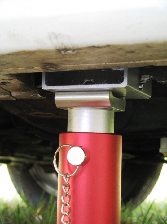

    They would, however be ideal, if there was a slot milled or sawed on their tops to accommodate the "pinch welds" on my Prius"v." They will be a future project. I don't think it would weaken their tops. It wouldn't be tough to mill a couple of 7/8 inch deep slots through the side wall of the tune and the aluminum top pad, and then, to cut off the remaining top pad with a hack saw.

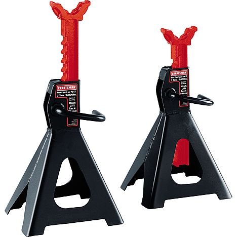

  15. gliderman
    gliderman Active Member
    Aug 2, 2011
    751
    225
    That's interesting. Almost every jack stand that is pictured when I search google for "jack stand" has a slot to accommodate a pinch weld or Unibody.
    And I bought mine from Harbor Freight years ago and they work great on a Prius!

    767

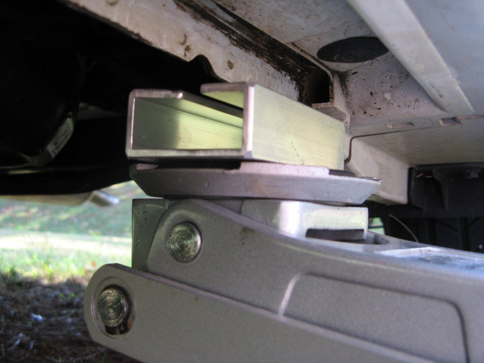

    More photos of "pinch weld" adapters on jack stands. Enjoy!

  18. gliderman
    Aug 2, 2011
    751
    225
    Here is one so you know what they look like. Everybody sells this type and have for years.
