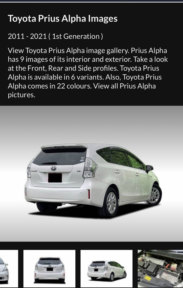

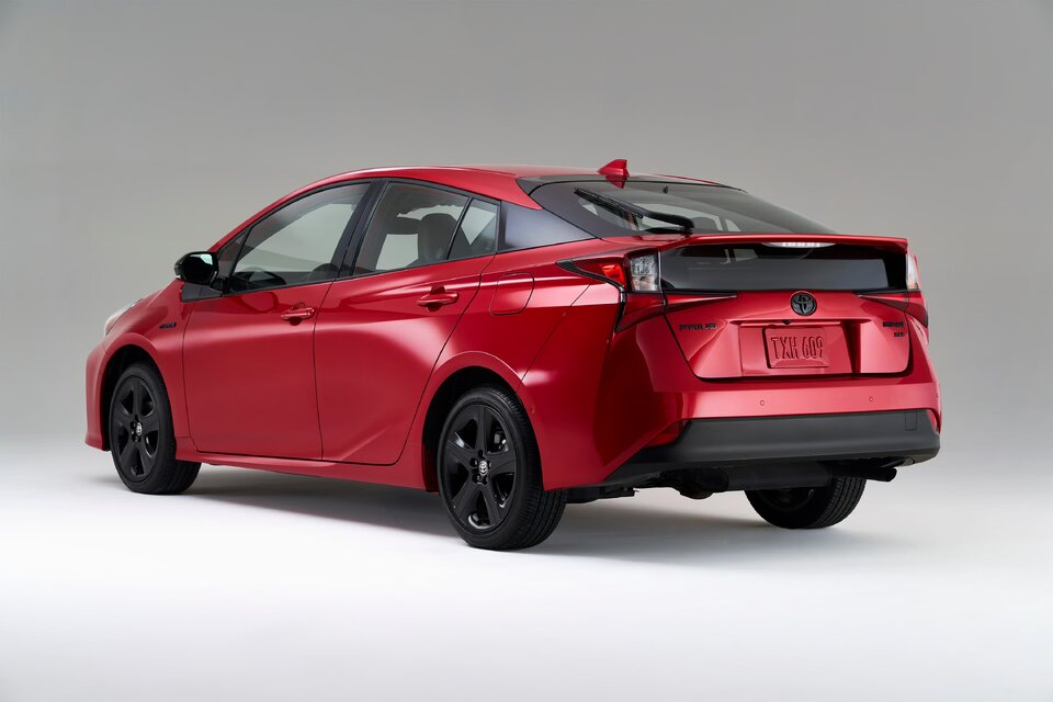

    vs this gen3

    Yes gen4. First picture
