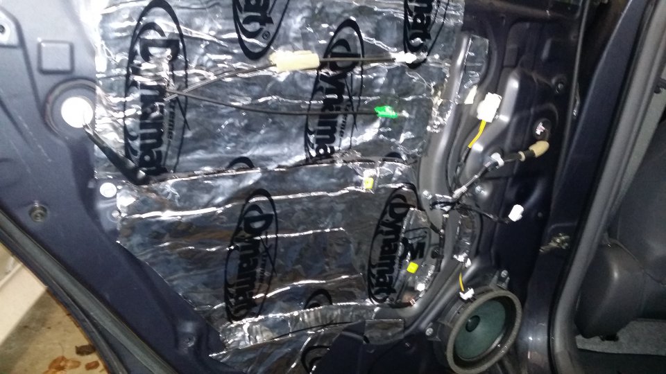

    3. I am big on sound deadening, and as much as i love the prius, it would have to be the worst car i hve ever owned in terms of general noise that enters into the cabin. So i pulled the rear door trims off to inspect what was there and found my problem....the doors are empty. So i started the process of applying dynmat on the outer and inner metal as well as a layer of Response (tripple layer) sound deadening. So far i have only done one door (rear right) and it is so much better already. Tonight i will work on the remaining three doors and over the weekend i will do the boot space. But for anyone who is considering deadening, or for anyone who hasnt done any deadening, it is definitely worth it. Not only does it cancel out a lot of noise, but it gives a much more premium feel to the doors and the way they close. Of course, the added weight may negatively affect fuel economy, but only marginally.

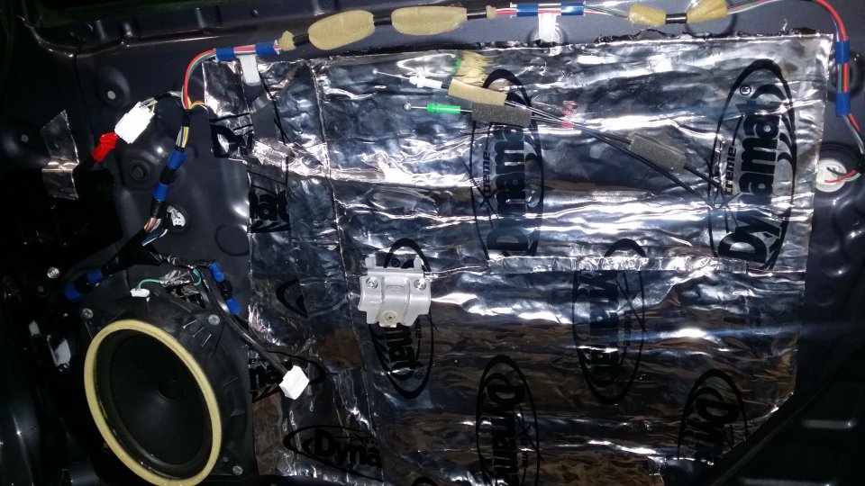

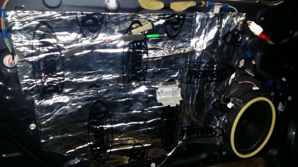

    So after three nights, here are some picks.
    The results make it totally worth it. Not only is the car a lot more quiet but the stereo is far more effective.
    I highly reccomend doing this mod :)

    What would be the costs for all 4 doors + other areas (specific areas please).
    Do you think substituting cork sheets could do the trick also?
  9. Ed Law
    Ed Law New Member
    Jun 25, 2014
    Australia
    Hi mate.
    I used dynamat with response super sound deadened from jaycar.
    I don't think that cork sheets would do the job as it needs to be dense.
    The reason why I use the type of deadening that I do is so that I am able to block a large spectrum of sound.
    I have deadened all four doors and the boot so far. And I still have a sheet left from a 36 square foot pack of dynamat.
    It has cost me around 400$ so far but I did the work all my self.
    :) sorry I took so. Long to respond!
