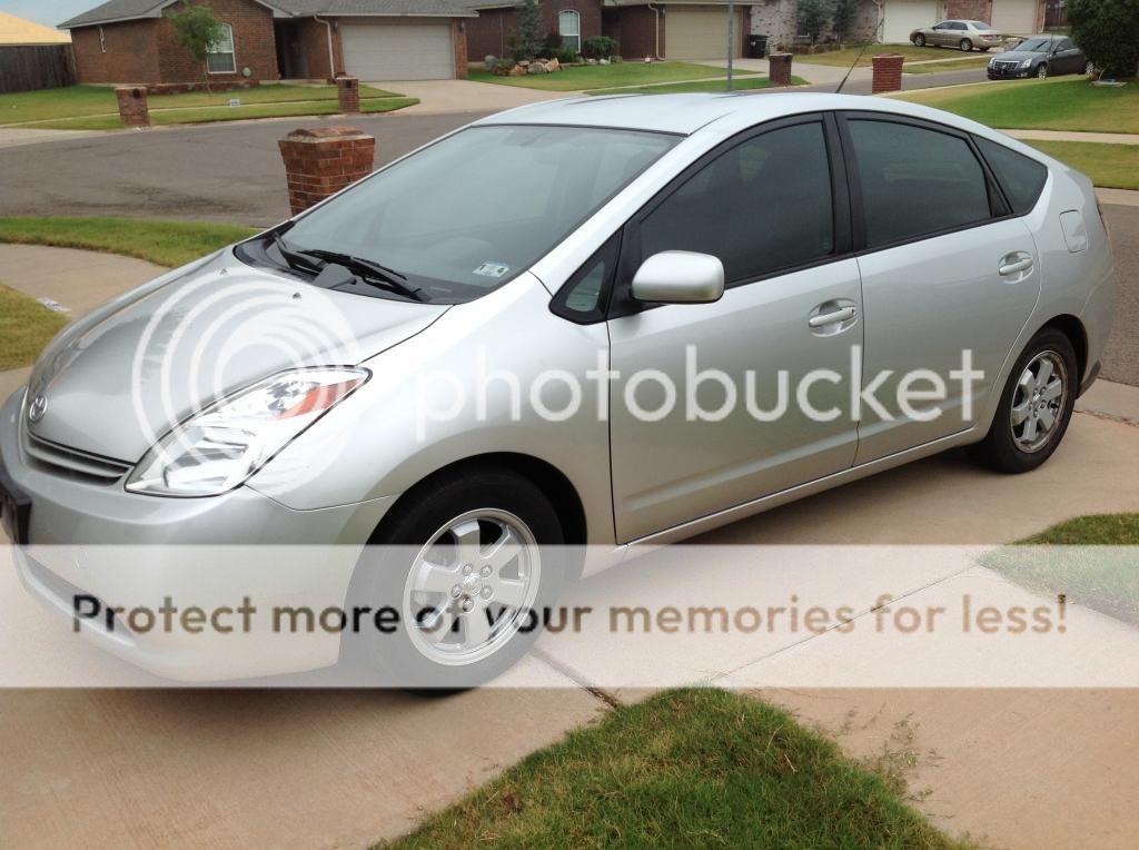

    Alright, I'm back! Turns out the 2008 I looked at was a POS. You could tell just by looking at it that it was not cared for at all from the inside out. Made a terrible exhaust noise, headliner was ripped, seats were filthy, interior panels were all scratched up, just blah. However! I did find a 2004 with 113k miles that was very nice inside and out. Drove it around for about 15-20 miles. Checked all over the car and everything was in great shape. Carfax was good. There was a ton of service history from a local toyota dealer on the toyota owners site. Tires were pretty new, the 12v battery was replaced 2 years ago and still tested good. I'm going to perform some maintenance over the next few days and get everything fresh. I just drove it from Arlington, TX back to OKC, OK so at least I made it home! I will try to get some pics posted later if anyone cares to see. Haha.. :LOL:

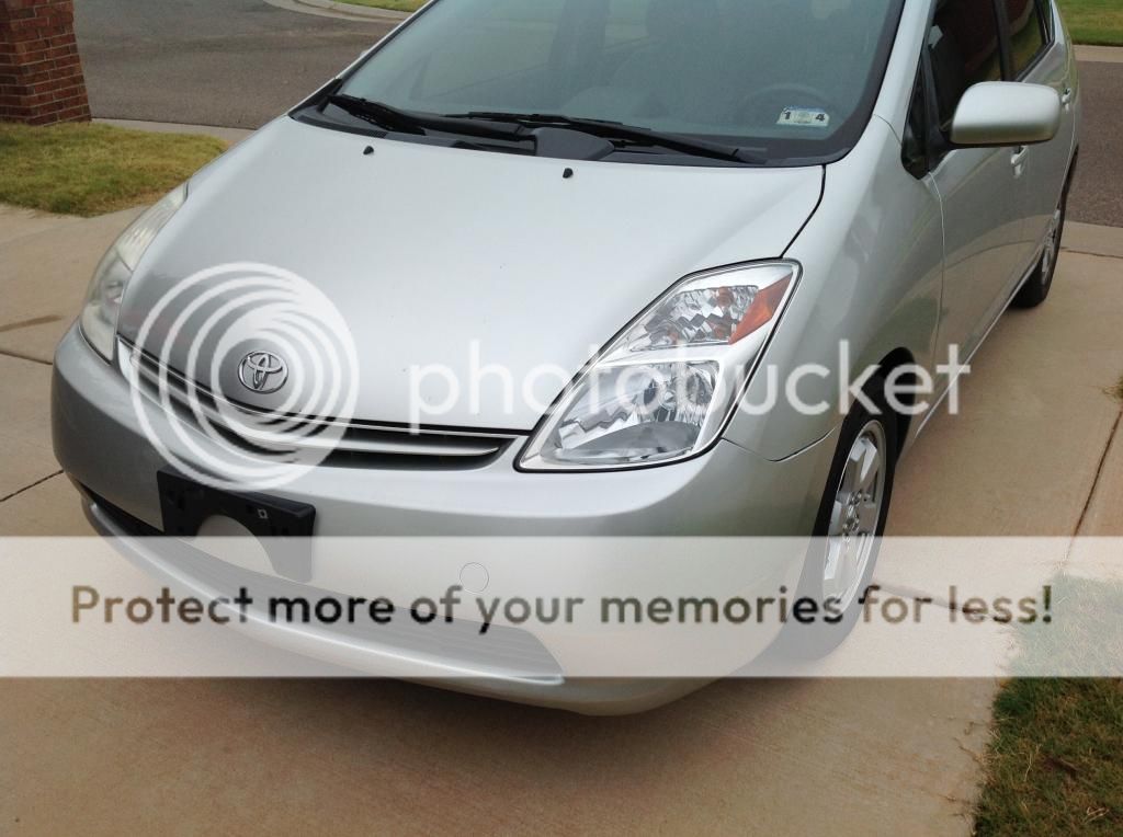

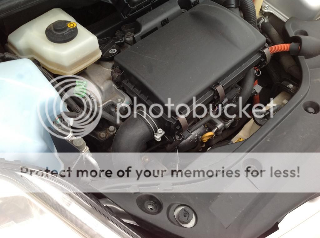

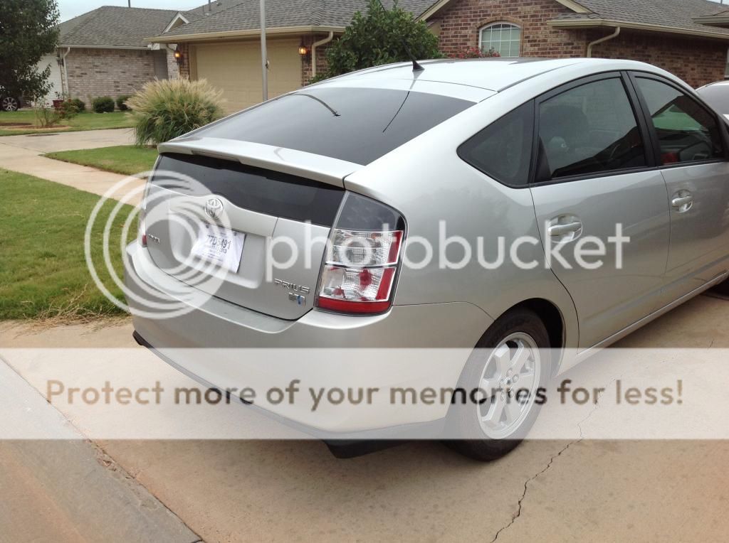

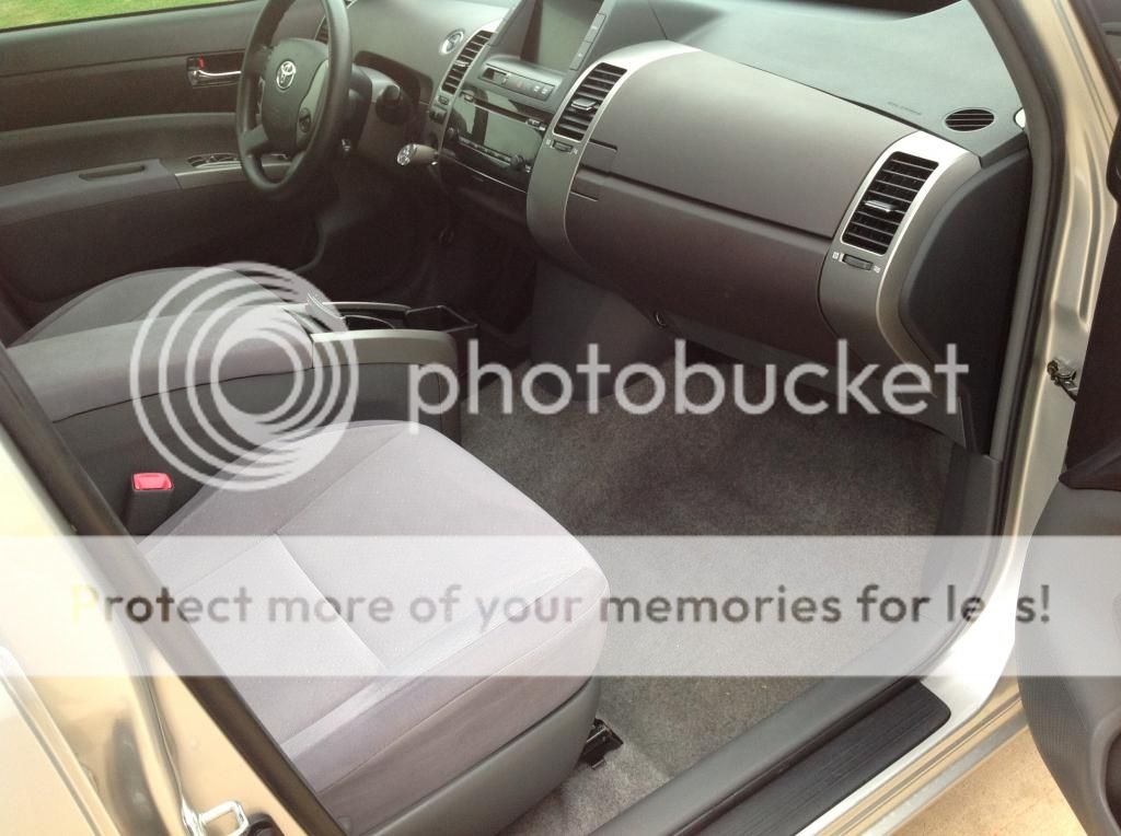

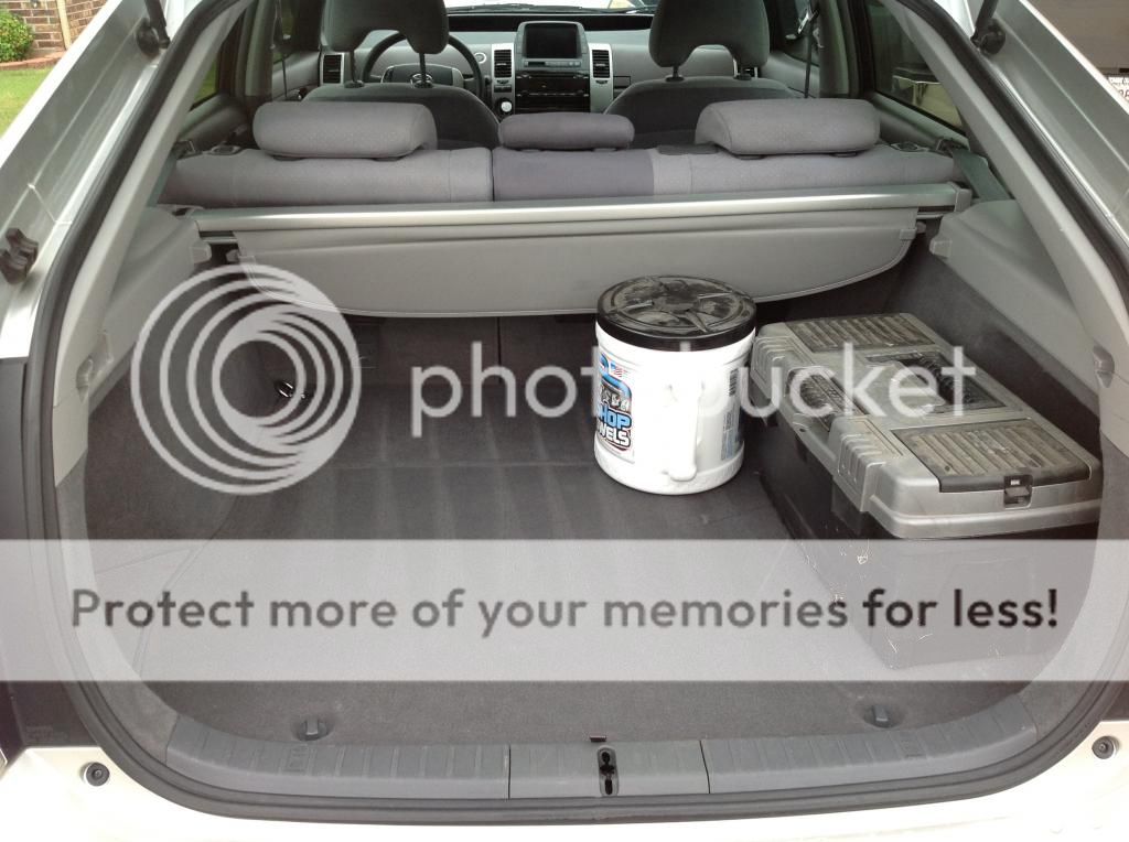

    Here are some pics!
    Ignore the dirty toolbox.
  12. usnavystgc
    Jul 29, 2011
    3,159
    974
    Tucson, AZ
    That is a very clean 04. Congrats!! How much did you have to pay? Is there a scratch or a ding anywhere?
  13. SteveLee
    SteveLee Active Member
    Sep 15, 2012
    634
    172
    North Carolina
    I
    Nice. I have noticed the hood paint on these cars get dinged over time. Probably needs more or better clear coat in that area. But that is one nice looking 04.

    Nah, I'm not scared. Oh, mine had two of the wheel covers on it and one was all scuffed up real bad. I just yanked those two off before I took the pics. I may get some new ones. I haven't decided yet. I checked the oil and it is right at the top line and still looks pretty clean. I might go ahead and switch it to Mobil1 soon. I was looking through the service history and Toyota changed the coolant in both the ICE and the Inverter at 80k which was 11/28/2011. The fluid still looks nice and pink, so I might let that go for a while. I will do the drain and fill on the transmission for sure. I am also going to get a set of plugs and a few other things as well. Probably get the Densos. ;)

    Good looking car man, I just bought mine a couple weeks ago and is almost same mileage as yours... Yours looks much cleaner. Guy above mentioned hoods of prius get dinged up over time, that's very true for mine. I ordered the stock gold touchup paint from Toyota for 10.01$ just an fyi. May our "new" cars carry us over the roads for another 200k miles! Congratz!
