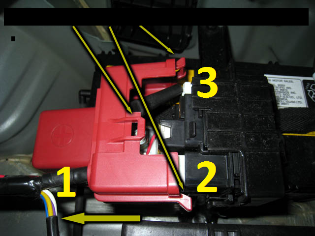

    Alright, so I think this picture is actually from a post by you, so sorry for taking it.
    Anyways, 3 questions/descriptions.
    Is 1 the wire I would be replacing? or is the one connected at 3?
    (and how would I even start going about that lol.)
    I tested the terminal connector located inside 2 and it is still a solid 12.9 volts.
    The cable at 3 refuses to come out no matter how hard I pull. There is also only one, even though it looks like there should be room for 2. Is this alright?

    I suggest that you use a large flat screwdriver to pry off the red plastic cover so that you can easily see what is going on. There will be one very fat cable that is connected to a 120A fuse. Use your meter to verify that there is 12V on both sides of the fuse, and that the cable also has 12V. You should be able to find a problem somewhere there.
    If not, pls take a sharp photo of the positive battery terminal after removing the red cover, and post.
    You will also see a very thin wire that is connected via a 5A fuse, and that provides sense voltage to the DC/DC converter so that unit knows how much voltage is being provided to the battery when the Prius is READY. There should also be 12V on both sides of that fuse.

    Should I cut open the rubber on the 120 A fuse to test the voltage?

    It might be better to use a needle to pierce the rubber so that if the fuse is OK, you don't loose that protection.
