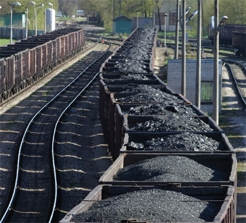

  12. hill
    21,524
    9,038
    maybe true in a little country like Scotland or the UK, but in the U.S. they can travel hundreds of miles:
    then consider the U.S.'s gluttonous usage ... 1,300 coal trains a year, and TWO THOUSAND MILES of coal cars:
    A Reporter at Large: Coal Train-II : The New Yorker
    No one hogs power like us. . . . Burp.
