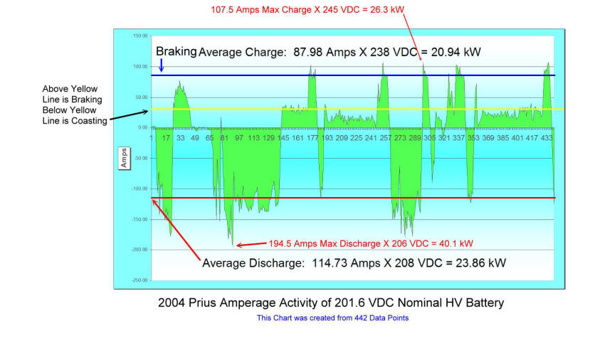

    I agree with andi1111's reply, these fuses are made to withstand more amps for short bursts (10 seconds) that they are rated to.
    Wayne Brown has a photo of his Gen2 HV Batt Fuse.
    [​IMG][​IMG]
    Although it is rated at 125A, he has recorded instantaneous current of up to -194.5A.
    Vincent

    125A fuse is proper sizing for the 25KW Gen II. Proper sizing for the phv if it allows for 38KW continuous would be 183A, but those are not common, so 200A should be used if troyota does not have a special size made. Sure some bozo in a stereo shop may put in a 150A for such a load, but I would expect toyota to be more professional. The fuse should be there to blow if something is wrong not under normal operation. Accelerating to 60mph @38kw will take much longer than 10 seconds.

    To maintain 62mph (100km/h) on a highway, a car only needs aprox. 17kW. See the attached image.
    Where you do need 38kW is when you're accelerating hard, but still you won't need 38kW from 0mph. At 0mpg you need the torque, not power. You need 38kW at 25+mph. But the acceleration from 25mph to 62mph takes less than 10 seconds, so the Prius' fuse is plenty.
    I also attached a picture of Vectrix' acceleration from 0. Maximum speed is governed by the electronics and is set to 62mph.
    Vectrix has 125A fuse and the red line represents the time when the current is higher than the fuse rating. As you can see, the 125+ amps are not drawn from 0mph, but starts at aprox. 25mph. After Vectrix reaches 62mph, governor drops the current demand, which falls below 125A for maintaining 62mph.
