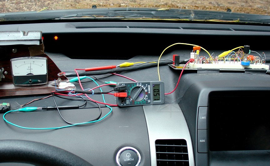

    When your Volt dash looks like this, you might get hobbit level respect.

    I do work like this on real live aircraft on experimental certs. I use high-end test equipment on 6 mon. cal cycles.
    I have no interest in back engineering an old-tech Ni-MH powered hybrid.
    But this is exactly where the PiP came from!
    If I could build a car, it would be like a Volt, only a thousand lbs. lighter, but then no 5 Star safety rating....
    BTW, his power switch, while funny, is unsat.

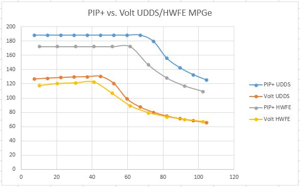

    Here's a fun experiment in data extrapolation. Taking the ANL D3 data, we can estimate what the relative efficiency of the Volt and a "PIP+" with no changes other than enough battery to utilize a similar amount of AC Wh as the Volt would be on the urban UDDS and highway HWFE driving cycles. Clearly this is a theoretical comparison, but one that I find rather informative regarding the efficiency of HSD design.
    For this theoretical case, the PIP+ and Volt would stack up as follows after ~100 miles:
    Urban UDDS 14 cycles (104.4 miles)
    PIP+: 13.246kWh AC + 0.440 gallons gasoline = 125.5 MPGe
    Volt: 13.012kWh AC + 1.205 gallons gasoline = 65.7 MPGe
    Highway HWFE 10 cycles (102.5 miles)
    PIP+: 12.503kWh AC + 0.569 gallons gasoline = 109.0 MPGe
    Volt: 12.753kWh AC + 1.155 gallons gasoline = 66.9 MPGe
    Interesting.
    Rob

    Specs show the Volt battery weighs 435 lb and the PiP battery weighs 176 lb – a difference of 259 lb. Hard to imagine the differential in weight would hurt the PiP’s efficiency too badly.

    Is that graph (with no x-y descriptors) Wall to Wheels or Battery to Wheels?
    The Volt has a TMS. The PiP has a little fan.
    This is to keep the battery in a 'happy temp' range while being used or sitting charging. Hot or Cold.
    What is this number representing? I don't understand: PIP+: 13.246kWh AC /// Volt: 13.012kWh AC
    I thought MPGe was for electric consumption? This is some hard to understand combined, "blending" test.
    Also one of the cars is sporty, can pull some G's on its big fat 17" tires. The other one, not so much.... Equals more rolling resistance, at a cost.
    I thought the car weight is close to 800 lbs different.

    I asked about the data misc posted above. I like facts and figures. I'm sorry, I don't understand what was posted.
    Can you send a link to the original site? It looks like good data. Is it from that Argonne link?

    As for the graph up above, it could stand with some captions or explanation. However, if this stems from my Prius A vs Prius B hypothetical, there is a lot to be considered when trying to translate a figurative car into a real one.
