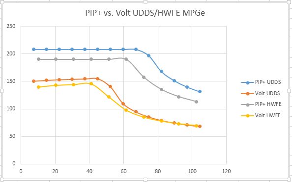

    Excellent. When you don't like what the data has to say, attack the formatting, act confused, and obfuscate.
    Yes, its wall/AC. As it says in the text before and after the graph. So just how much power does the Volt's battery cooling system waste, and under what range of temperatures?
    Yes the source is the Argonne (ANL) data as mentioned.
    Incidentally, here is the same calculation made from the DC data.
    MPGe is the total amount of energy consumed from any source, expressed in terms of its gasoline equivalent. Hence the e. X axis is distance in miles. Before the "knee" both vehicles are running all electric, after that the gasoline consumption starts pulling down the average MPGe. The knee for the PiP+ comes considerably later, as its able to get more miles per kWh of electricity. The PiP+ also gets pulled down slower after it starts burning gas, as it gets more miles per gallon.
    800 lbs may be the difference in vehicle weight, but iplug clearly stated he was talking about the difference in battery weight. I would say his assumption is correct, as to the best of my recollection most Gen II Prii with a 10kW plugin conversion saw little to no impact on mileage from the extra weight, and often get slightly better mileage just as the PiP does.
