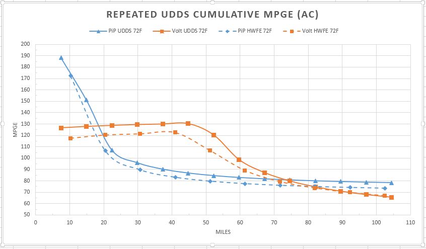

    Just to be clear I make no assertion that the graph I put out is real. It is what it is. An extrapolation of existing data for all other things being equal. Yes, the added weight of incorporating the larger battery could easily nudge it down, or other factors could nudge it up a bit. I still think its interesting as a tool for observing raw relative efficiency of the existing vehicles as it strips away the most confounding difference, the size of the battery.
    Basically for methodology I took the ANL D3 test reports:
    Argonne TTRDC - D3 (Downloadable Dynamometer Database)
    brought the numbers for distance, electricity, gasoline per cycle into Excel and added cumulative calculations. I also added calculations for AC/DC efficiency based on the same data reports, gasoline equivalence of electric consumption, and MPGe.
    For straight Volt vs. PiP calculations, I repeated the statistics from the last fully CS run until arriving at the distance of interest. For the "PiP+" I continued to add CD runs between the first run and the first partial CS run until the total amount of AC power consumed was as close as possible to the reported number for the Volt. This is not exact, as I am only using integer numbers of runs, not trying to interpolate.
    BTW here is the similar AC MPGe vs. distance comparison for the straight PIP vs. Volt case at 72F.

    Thanks for the added descriptions of your extrapolation and the new graph. I'll try to spend some time pondering it over the weekend.

    Thanks for putting it into a graph.
    Also, it is only vehicle operation efficiency. It will be interesting how it will look if fuel production is considered.
