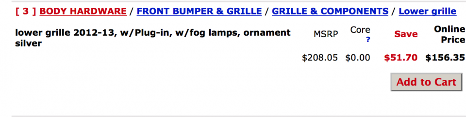

    Your local dealer would have it. show them this Screen Shot 2014-05-08 at 12.30.51 PM.png
