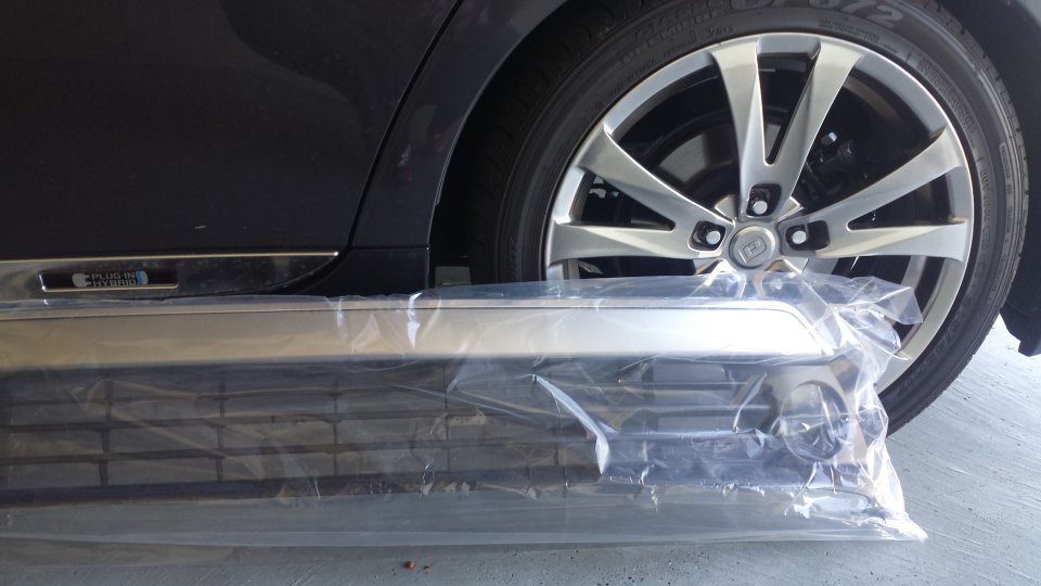

    20141008_154315.jpg Well i finally bought the Plug-In Lower Grill Insert. Comes with the metallic trim on top. Part number# 5310247090B1. If you don't have a favorite parts store yet, try Ryan with Elmore Toyota somewhere in California. 1-800-997-9092

  9. bzyrice
    bzyrice Active Member
    May 15, 2011
    805
    324
    West Palm
    Cool.. I still need to buy that lol

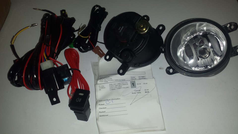

  10. Potorap
    Potorap Active Member
    Mar 18, 2012
    345
    148
    Pahrump, Nv
    Hey Maddy,
    What fog light kit did you purchase?

    Ebay item #
    381008932345
    I should receive tomorrow or Friday.

    Well i got it today! The switch looks perfect and so does the rest! AND! It actually came with H11 bulbs installed. By far the most inexpensive that I have seen! 20141009_141942.jpg

    Maddy,
    Thanks for the pics. Please send me pics of the way it mounts into the bumper when you get to that point. Also of the switch when it is mounted. Thank you so much.

    If it's the standard Toyota foglight mount, two tabs on one side of the foglight slide into slots in the grill or shrouds, then 1 screw holds one of the two tabs on the other side of the foglight.
    The dashboard switch just snaps in place of one of the blanks in the cluster containing the dashboard illumination rheostat knob.

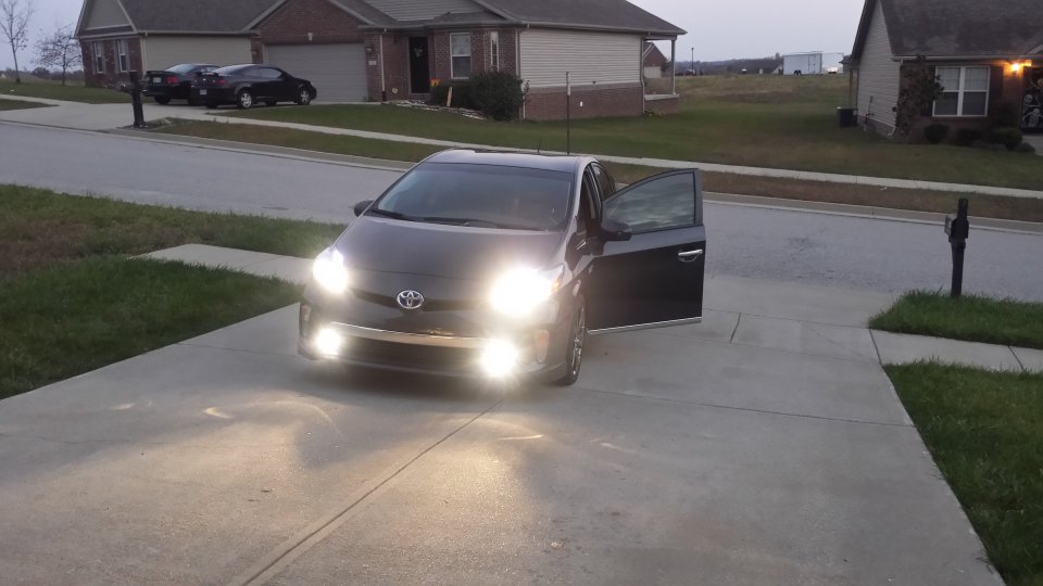

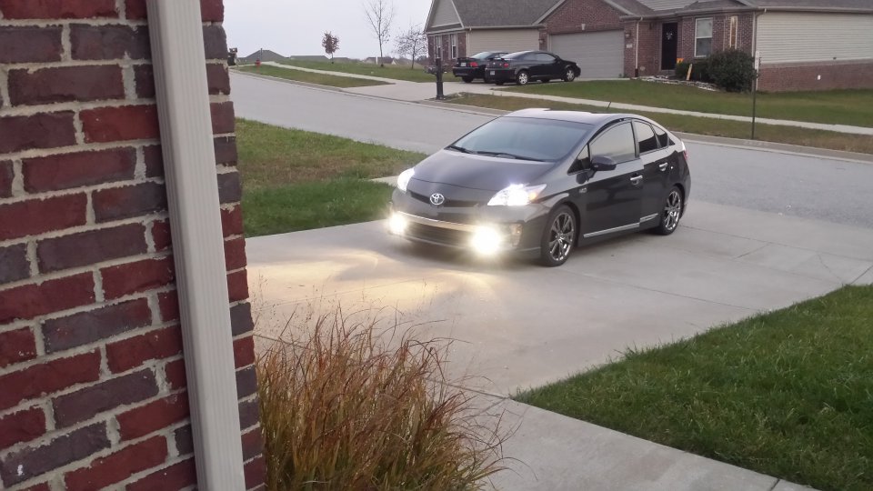

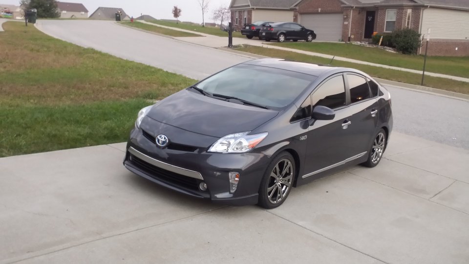

    Finally got it installed! If you have questions about any of the install, just let me know.

    Thanks for the info. What if I don't want the chrome piece? Could I use the grill fron the non-PiP?

    It should fit, probably cheaper too.
