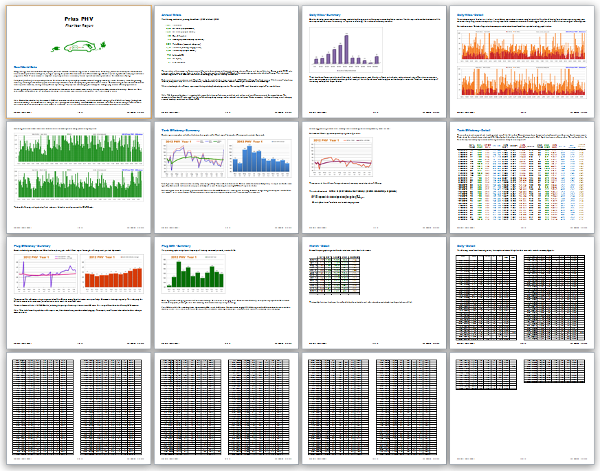

    Here's my latest labor of love:
    John's Stuff - Toyota Prius PHV - Annual Report
    It's 11-months of daily & tank real-world data I've been collecting. In a month, it will become my first annual report driving a 2012 plug-in Prius. But for now, the document is preview of what there is available so far.
    The thumbnail below gives you a general idea of what I was shooting for... lots of graphs and explanation of what they illustrated. Follow the link above to download a free copy.

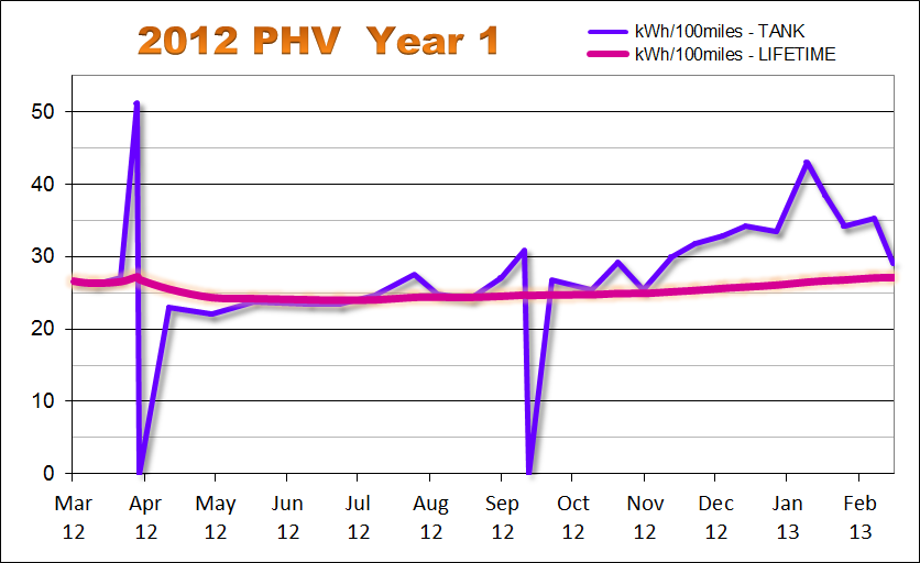

    I noticed the downward spikes in the graph on page 8 titled "2012 PHV Year 1". It might be good to add a brief description of what those represent and the impact that it has on the red lifetime running average.
  14. john1701a
    john1701a Prius Guru
    Jan 6, 2004
    12,840
    5,312
    Feedback like that is exactly why I rounded up as much as I could with the 11 months of data collected so far. It took quite awhile to figure out what was even important and how to represent it with so many choices available.
    Those two spikes are easy to see on the tank graph and basically invisible on the monthly. That's a good example. It shows when I went for a long-distance drive without the opportunity to recharge at all between fillups.
  15. Jeff N
    Jeff N The answer is 0042
    Oct 23, 2010
    2,382
    1,304
    California, USA
    2011 Chevy Volt
    The lifetime line takes a noticeable turn downward right at the segment where you couldn't charge (the downward spike to 0 kWh / 100 miles) although if you weren't charging at all I would think the lifetime trend would stay flat (no new data input). I wondered if the lifetime calculation was trending down right there for other reasons or if it was trending down because it was incorrectly treating that segment as infinitely efficient on EV. Someone else might wonder too, hence the suggestion to somehow clarify that in a footnote or some other way.
  16. john1701a
    Jan 6, 2004
    12,840
    5,312
    With so few total miles driven at that point, the dip makes sense...
    The odometer was only at 1,775 miles. Then for the next 663 miles only 8.7 kWh were used... which isn't even 3 full recharges and it's a massive chunk the total distance of 2,438 miles. That in itself is enough. I was also drove a few very short trips along with a morning with lots of stops... taking photos, because it snowed.
    Documenting that level of detail sounds helpful, but it's not practicial. I took some trips during the summer with bikes on the back and kayaks on top. Both cause a hit too.
    The point is to identify the trend overall. Does that line effectively do that?
  17. Jeff N
    Oct 23, 2010
    2,382
    1,304
    California, USA
    2011 Chevy Volt
    Sure, it generally looks good and captures the right idea of immediate data variation vs. long term trend. It just looks slightly odd for "no charging" to be graphed as 0 kWh / 100. I see what is really happening from the detailed tank numbers and I understand why you graphed it that way. It's just a question of initial perception by someone looking only at the graph. I don't have a brilliant suggestion for how to make it better.

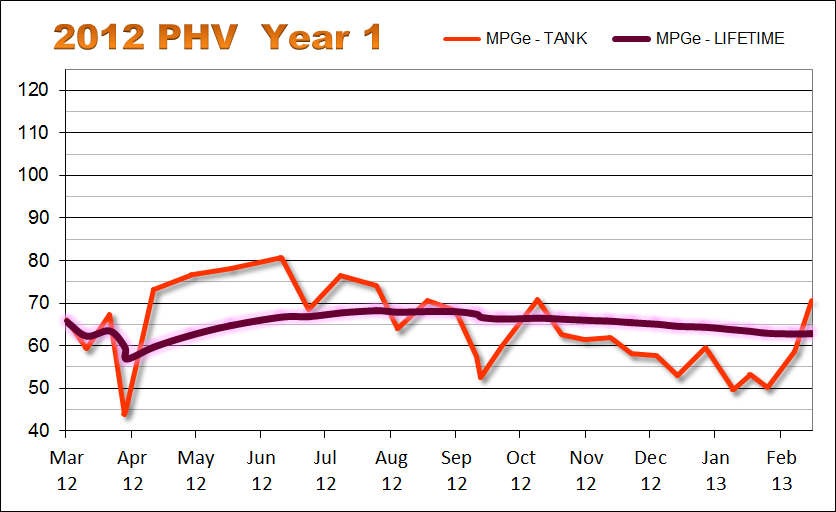

    (# EV miles + # HV miles) / ((# kWh / 33.7 kWh) + # gallons)
    Is that the correct formula for MPGe ?
    I've been working on a graph for the results of that to add to the document too...
    What I found interesting was at this scale, the MPGe Lifetime value looks very similar to that on the MPG graph...
    Of course, that does tend to make sense. It should correlate in some respect.
  19. 3PriusMike
    Jun 21, 2009
    3,101
    2,421
    Silicon Valley
    Yes, I've been using a more general variant:
    (total miles) x (gas energy per gal) / (total energy all fuels)
    You then convert all energy to the same units, such as BTUs, like this:
    miles x 115,000 / (kwh x 3412 + gal x 115,000)
    where:
    1 gal = 115,000 BTU
    1 kwh = 3412 BTU

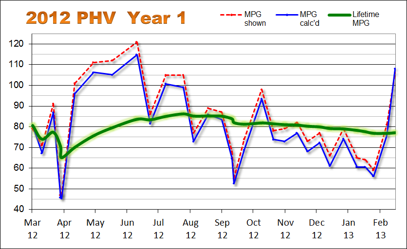

    Also, I would force the graph to range from 0 to 80 or 120 mpg, not to go from 45 mpg and up...because 45 mpg appears to be low. Maybe put in a line for the fleet average around 25 mpg for perspective.
