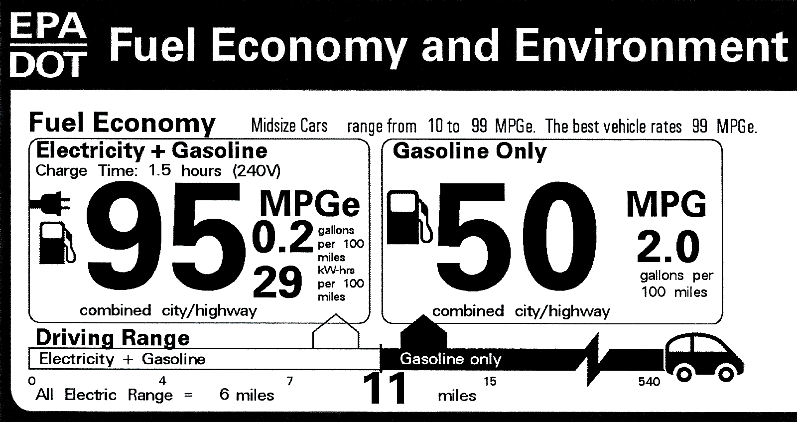

    More info to add to the document...
    0.2 gallons per 100 miles
    11 miles = 0.022 gallons
    29 kWh per 100 miles
    11 miles = 3.19 kWh
    (# EV miles + # HV miles) / ((# kWh / 33.7 kWh) + # gallons) = MPGe
    (6 + 5) / ((3.19 / 33.7) + 0.022) = 94.3
    Notice how the numbers come into play.
