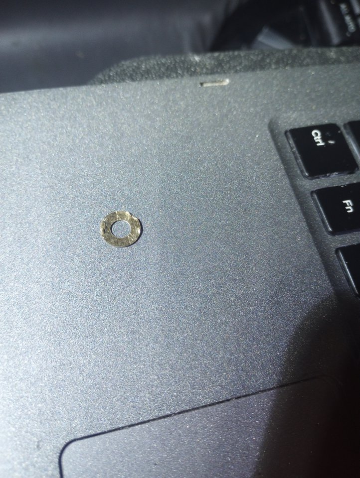

  3. black_jmyntrn
    black_jmyntrn Senior Member
    Oct 23, 2020
    1,729
    411
    2013 Prius Plug-in
    I recently tried this as I wait for a new outlet to arrive and no dice. does this work on all models? removed the wafer and no power. My outlet is hardwired to my 2nd 12V battery as well.
