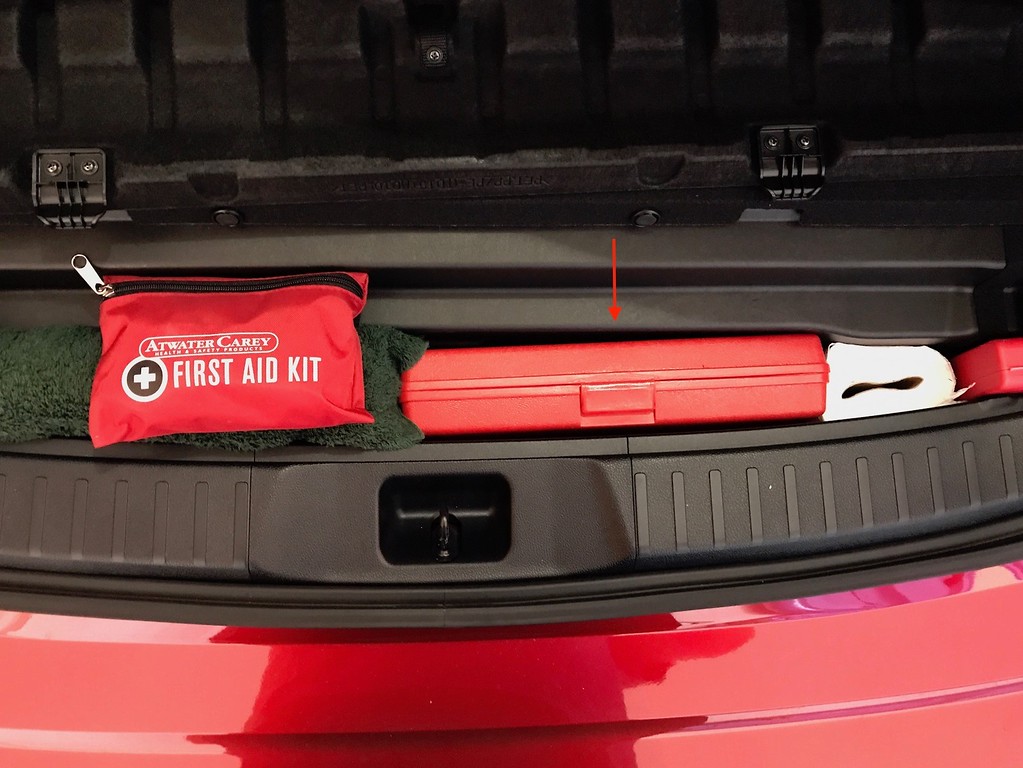

    Since there has been so much discussion here on the fact that a Prius Prime does not have a spare tire, I thought I would share my perspective as a new Prime owner. I too was worried about the fact there was no spare tire, but after giving it a lot of thought and a lot of research, I’ve settled on a good solution.
    For starters, the only time I’ve ever had a flat in 31 years of driving is in 2003 when I went out into the parking lot after work and noticed a tire was sagging and only half full from a screw in the tread. I know...flat tires can happen at any time, but if you think about it, it is pretty darn rare. One time in 31 years for me...
    As long as you maintain your tires properly, in the rare chance that you do get a flat it will likely be from a screw, nail, or some other kind of intrusion in the tread. Sidewall blow-outs on properly maintained tires are super rare.
    For objects that have punctured the tread, we obviously have Toyota’s flat repair kit. The problem is Toyota’s kit is a one-time use and it makes quite a mess inside your tire. This increases the repair cost and you have to replace the TPMS (tire pressure monitor system) in the effected tire as well. That can make for a pretty expensive repair. Furthermore, after using Toyota’s one-time repair kit, you have to buy another one and you guessed it: they are expensive.
    The better solution, which I came across right here in the early stages of this thread, is to add the Safety Seal KAP30 Pro Tire Repair Kit to your arsenal. This excellent kit is what a tire repair shop uses when you take your tire in for repair and it is very easy to use. I’ve read numerous reviews from people that have used it and once you know what you’re doing, you can repair a flat tire in less than 10 minutes, which is arguably less time than it would take to use Toyota’s patch kit. And unlike Toyota’s patch kit, when you use the Safety Seal kit, you’re actually done. Most of the time, no further repair is needed. And last but not least, you can make up to 30 repairs with this kit, so it is not a one-time use.
    I bought my Safety Seal kit from Amazon for $36, but that price seems to fluctuate up and down. You can also buy it directly from the manufacturer for a fair price. I’ve heard from plenty of people that 3rd party kits that look comparable to Safety Seal are actually junk. The original Safety Seal is the way to go.
    Next up is where to store the Safety Seal kit. It actually fits nicely in the slender storage compartment in the back. The Safety Seal Kit is the red plastic case in the picture below.
    The last piece of the puzzle is an air compressor to put air back into the tire after making a repair with the Safety Kit. (Toyota’s air compressor can only be used with their gu/slime and not as a stand-alone compressor.) For this, I bought a cheap car-kit air compressor from Amazon that was slender enough to fit under my front seat.
    Problem solved. Flats are pretty rare, but I’m now prepared to handle 95% of the flats that do occur.
