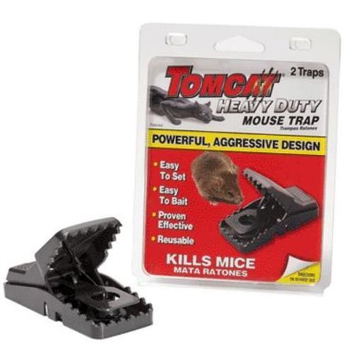

    Yeah, besides being gruesome they are more expensive in the long run and disposal is a hassle. We use TomCat claw type traps with removable bait cups. These are far more effective than cheaper models without the removable bait cups, as no weight is loaded onto the actuator until the rodent is on it. Also easier to bait and no-touch carcass release. We also use the larger sized ones for bigger rodent "guests".
