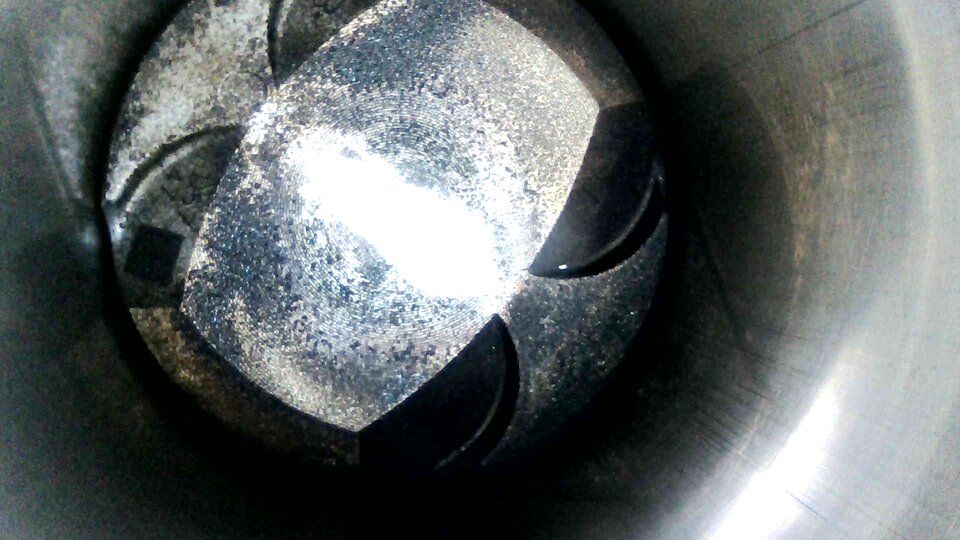

    Had some spare time, my endoscope, wrench and sockets and my endless curiosity to try and look out hidden things.. what do you think of this. I think it's clean enough for 51k km but the "scratches" on the cylinder bore kind of worries me. I hope it won't prematurely get harmed by diluted oil. Might consider using only 0w20 from now on.. Also, i don't know if the scratched side is facing the direct injectors (exhaust side) or are they on the intake side. I could very well see the direct injection washing the cylinder bore and causing wear. Time and a $#!t ton of miles will tell...

    i notice the same thing - the engine runs very rough if not used for 2-3 months. Shortening the time between engine runs make the engine starts much smoother. I thought it might something to do with bypass in the filter not sealing 100% and allowing the oil drain from the engine galleys.

    this does not look good at all :( My subaru engine bores looked brand new after 175000 km, 17 years and tons of run-hours sitting in traffic. Please tell us more about your driving habits, engine run patterns and oil change intervals(distance and time). I did UOA on my Gen4 prius prime with port only injectors and oil had 5% fuel dilution! And i was careful not to short run the engine! Direct injectors should be much MUCH worse in terms of dilution. in your case 0w-16 and 5% dilution = no engine protection. Please give us more details. Thanks.
