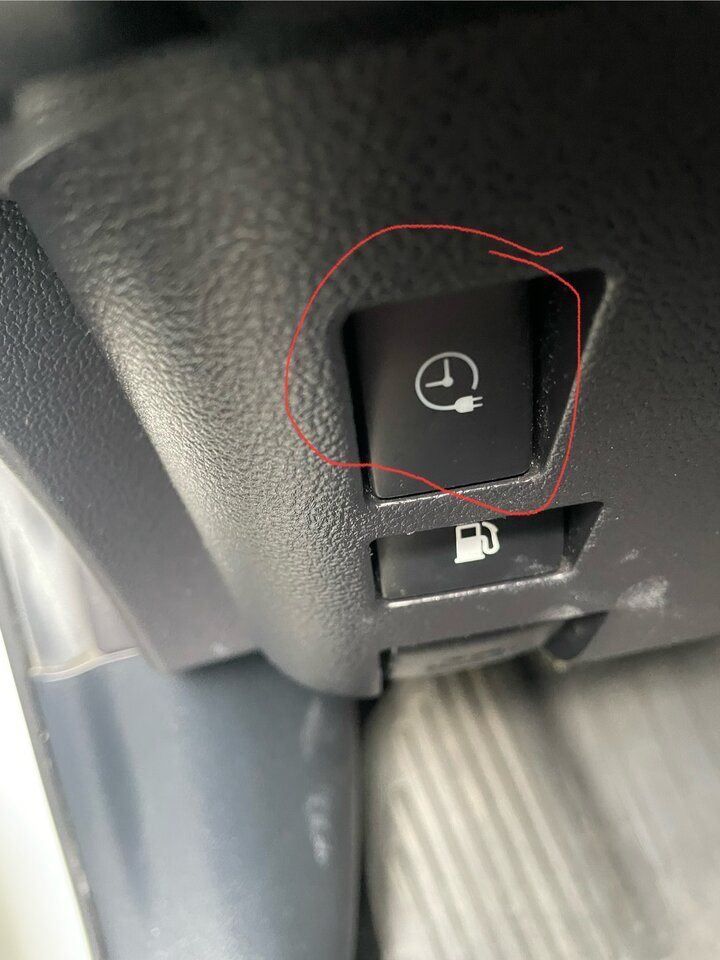

  14. richard203
    richard203 Member
    Jan 23, 2019
    284
    61
    SF
    ----USA----
    Any1 know what’s this do?
  15. bisco
    115,480
    52,863
    looks like a charge timer, but idk
