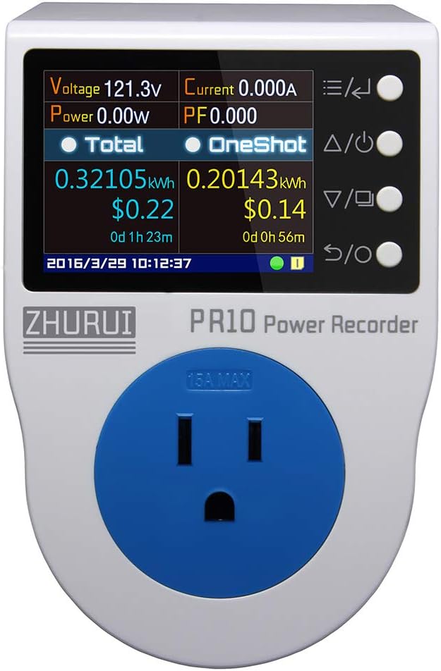

    So, you have verified that the OEM 120-V charger works at 240 V without smoking? Are you using a plug adapter?
    This is the watt–hour meter I use with my OEM charger. I recommend that you get it as well:
    otatrant likes this.

    Charge adapter works really well on 240 V circuit. Haven't noticed any excessive heat from the charger and have been using it with an adapter for about 4 days now.
    Used Rob43's thread Using the Primes 120v Charger at 240 Volts, Cost $20 !!! to make adapter.
    I will have to look into getting a watt-hour meter. Thanks for the recommendation.

    Purchased ZHURUI PR10-E US15A Power Meter Plug. Higher max power rating for 240V. I'll recalculate my numbers once I get it and post my results.
    Gokhan likes this.

    That watt–hour meter looks like a very good one. Let us know what the current displayed is well as well.
    If you could find out what the kWh for 100% SOC is, that will be very nice. It is probably charging at 2.88 kW; so, it is not quite full-current Level 2 but close. Your watt–hour meter should display that as well.
