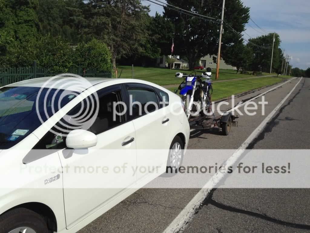

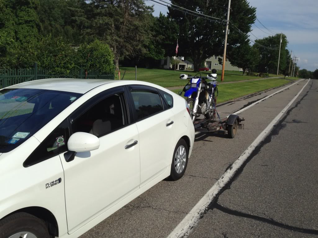

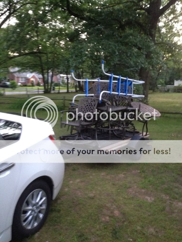

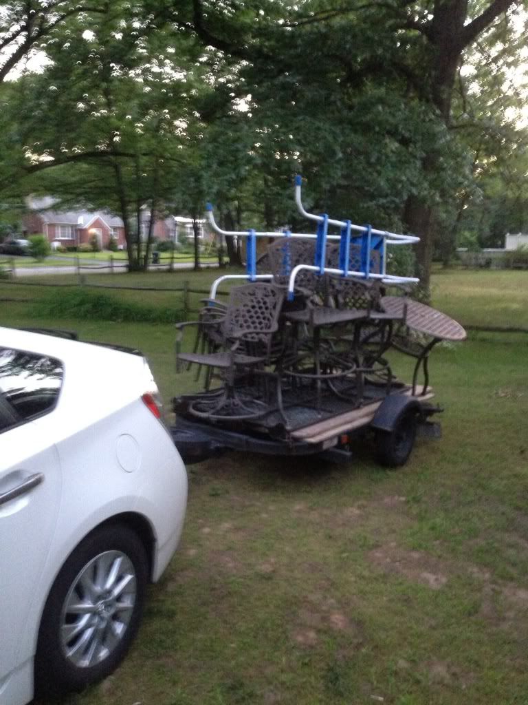

    I bought this 3 rail motorcycle trailer 25 years ago for $250. After realizing I don't trailer my bikes that often and I decided to make it more utilitarian while not losing its original purpose. Over the years I have gotten rid of the stub axles and got a through axle increased wheel size to twelve inches. Repainted it and it has lived inside most its life lifted flat against a wall in the garage. Always towed great.
    I have towed it with various motorhomes it has hauled two transalps and a BMW 650 at the same time. Now I tow it with my prius and with a wr250r behind the car I averaged 44mpg.

  13. kurbmaster
    kurbmaster Junior Member
    Dec 12, 2012
    46
    24
    The plywood bottom and sides are hinged and slotted on both ends. I slotted the tail gate and front gate so it can become a box trailer. Most useful trailer combo I have ever had. I should build a little teardrop that I can bolt on the frame.
    sabasc3 and engerysaver like this.

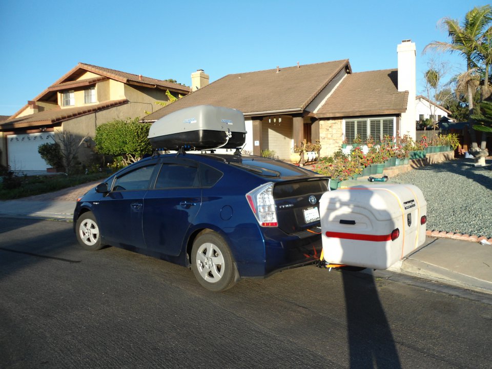

    How much tongue weight would you risk?
  15. kknguyen1168
    kknguyen1168 Member
    Jan 15, 2011
    453
    35
    san diego
    the tongue can carry 200bls max, and can pull 2000lbs max, that is standard
  16. markabele
    Mar 27, 2012
    5,084
    1,782
    Nebraska
    Are there any circumstances where you might risk slightly more than 200 tongue weight?
    (I'm asking because I'm considering getting a hitch with one of those cargo racks that go on the hitch.)

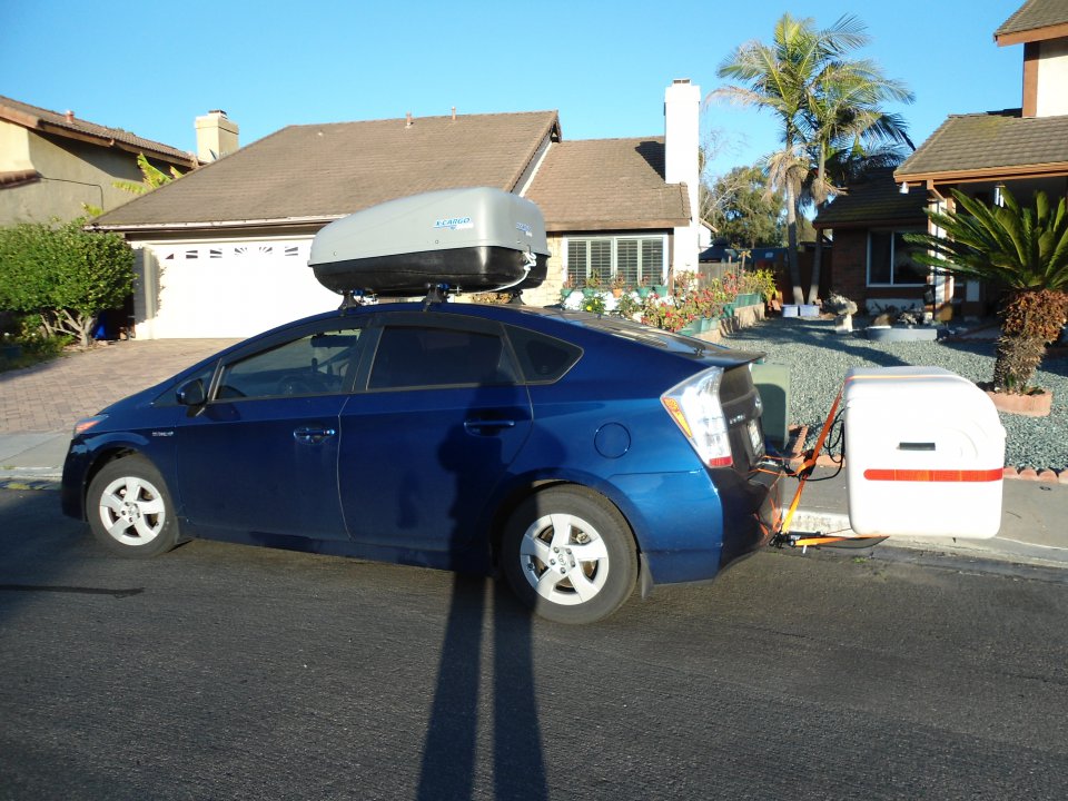

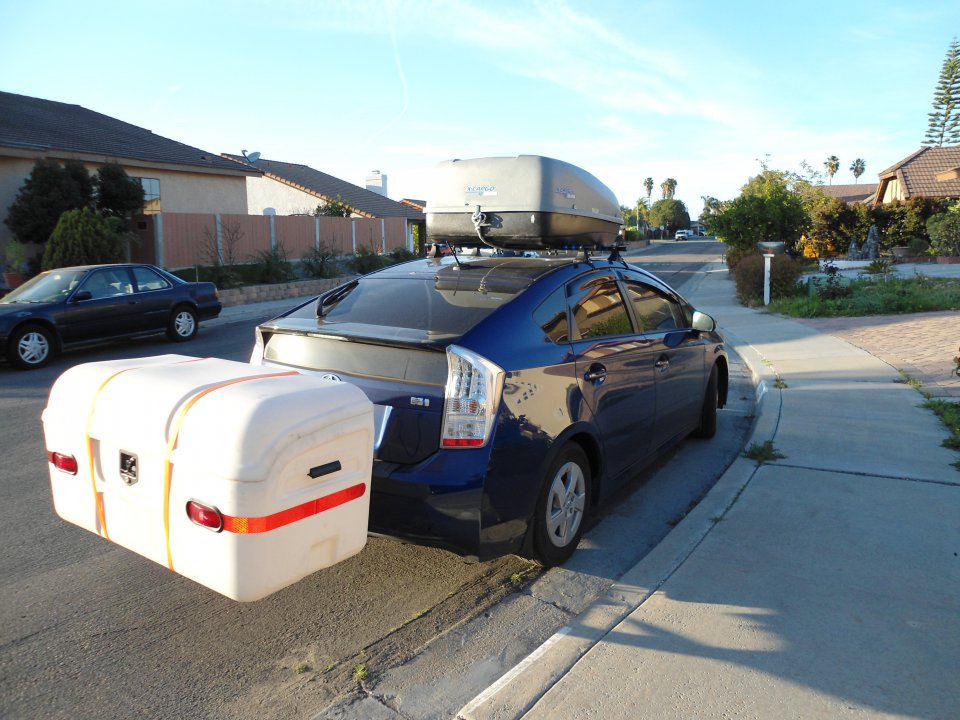

  17. kknguyen1168
    kknguyen1168 Member
    Jan 15, 2011
    453
    35
    san diego

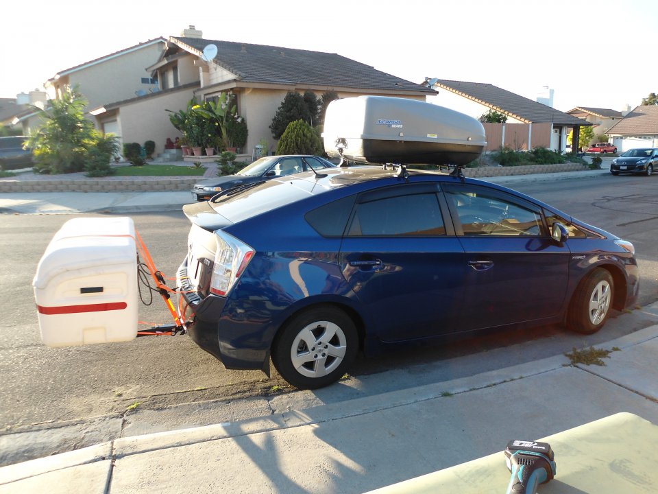

    you mean like mine:) take a look
    engerysaver likes this.
  18. markabele
    Mar 27, 2012
    5,084
    1,782
    Nebraska
    Wow, what does that container on the back weigh when filled with stuff? Also, are you required by law to have lights on it like that?

    Jan 15, 2011
    453
    35
    san diego
    yes it does had a light, and i got close to 200lbs
