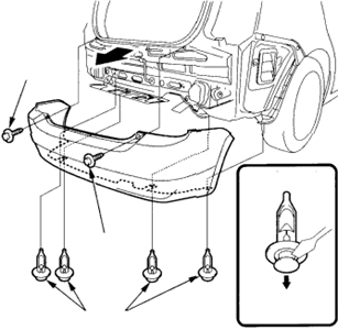

    Hi guys, was wondering if there were any updates to this topic. I found some instructions to remove the entire bumper and it seems like there are two clips that hold the top rear part of the bumper, on the left and right of the ledge, ledge being the thing below the trunk opening.
    I was wondering if it was possible that this gap is due to the clip being broken? My gap is getting bigger and bigger I feel like. Of course the dealership won't replace it for free since I bought it used and the used car warranty does not cover this. And of course they said they have to replace the entire bumper.
