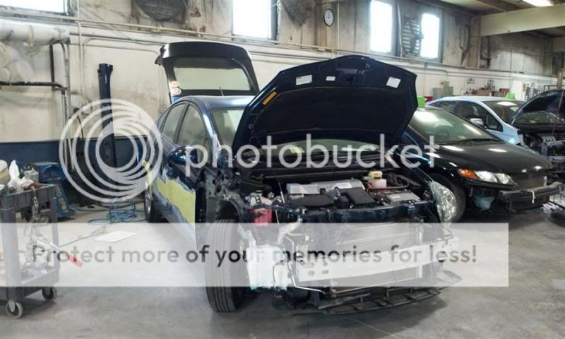

    Repairs underway.

    Read through your repair estimate and see if the garage says they're replacing your doors. From the photo you took, it looks like they're using quite a lot of plastic dent filler ( the yellow stuff on your doors ).

    The damage to the doors and quarter panel was minimal.

    All that bondo really worries me! If it were me I'd want the doors replaced & a new rear quarter panel than all that bondo. No wonder ur est was really low.
    All it will take is 1 door ding to crack the bondo
    spiderman likes this.

    If you look at the leading edge of the door, you'll see that there is no actual dent that runs the length of the door. The bondo is likely covering up a small crease or even just gouges in the paint's finish. If the bondo is applied that thinly, it is unlikely that being doored lightly to moderately would crack the bondo. If anything, it might help the metal to resist a ding. But I digress.
    Given the age of the car, unless it has high miles, I would demand new skin on the entire right side, including the quarter panel.
    Unless there was enough of an impact that damaged the door structure itself, there is no need to replace the entire door...just the skin.

    Yes I agree with the door skin & not the entire door......but I disagree about the bondo.......it will crack no matter how thin
    Either way......don't settle for bondo. It's a cheap fix

    Replace the quarter? Why? By the time the spot welds are drilled, ground smooth and straightened and welded, and the seams welded it will have more filler in it than it does now. And it won't be original to the car. Changing a front fender is one thing, but re-skining a door or changing a Q panel is a harder repair to hide unless the body shop is anal to the nth degree. If you live in a salt air environment and plan to keep the car forever, the repaired body seam splice is often one of the first areas to "age".

    First, with regard to you comment about not being the original car, I don't consider a car repaired with bondo to be the original car either.
    When I first posted about replacing the quarter panel, it was after looking at in the garage at the seam locations on my car and assuming that the entire panel would be replaced. After doing a Google search, I see that the replacement panel does not extend to the seams and there would be welds, so it's six on one, half a dozen on the other with regard to the filler. I will say, however, that one of the first corrosion locations I typically see on a car is around the rear wheel well, so if it were my car, I would prefer to have the filler at the weld seams.
    And of course it's harder to re-skin a door or replace a quarter panel than it is to slap on some bondo and grind it down. I don't think anyone was disputing that. What's in question is what is the best repair to maintain the integrity of the body.

    Well at least they aren't using lead. Modern fillers are way more durable and outlast lead.

    Agreed. I just used the term Bondo generically. But still, I would be hard pressed to want that stuff on my car.
