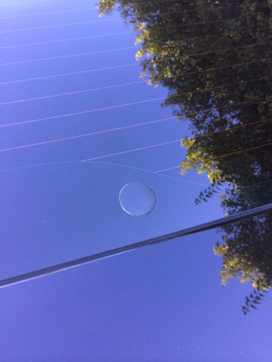

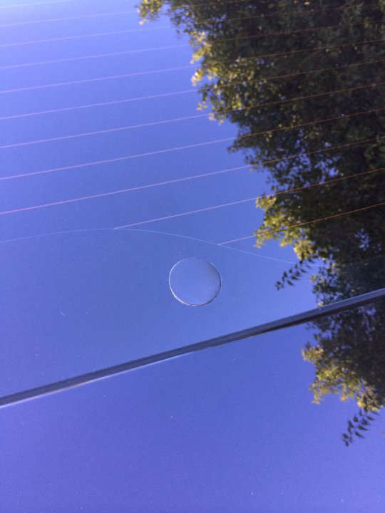

    Installation came out very clean with no modification needed. 321155446746_4.jpg IMG_3290.jpg Selling black nylon plugs for your rear wiper removal filler. Fit perfectly. $6.50 shipped to USA. Paypal. Message me if you are interested. Check out pictures.

    Looks well. I did it on two of my cars in the past as well. As you love in SoCal, you probably won't expect too much rain!

    lol at $6.50 Lowes plug with silicon mod. LOL DAFUQ

    I would have loved to have found a black nylon plug 1 3/8" ! I found a metal plug at Home Depot for $2-3, I don't recall. But I had to sand, prime and paint it. When I was cutting away the small amount of silicone sealant that oozed out, I nicked the paint job a bit. Even for $6.50 an already black plug would have been easier and worth it. :)
