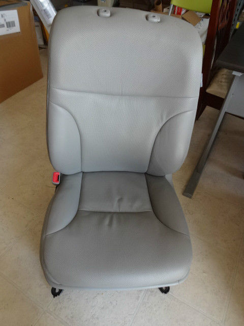

    Wouldn't a seat like this be a huge upgrade for a prius. It is power, leather and has the seat cooling heating unit that blows through the pin holes in the leather.
    Major obstacles, hooking up the in seat air bag, controls for the heating cooling $T2eC16h,!wsE9suw0PbNBSOh1GqJkQ~~60_3.JPG :
    Lexus es 330
    I Installed power leather front seats in my old 2000 honda mini van and it was a tremendous upgrade, well worth the $350 I spent on the seats. I ran a fused power wire under the carpet to power the seat motors, they bolted right in because it was a leather seat from the same model.

    I can't decide. I love my Prius but I find the drivers seat to be mediocre. I wish someone else would do it first. A power leather Prius 5 seat would be a really easy swap but that seat would be really hard to find. The next option is a seat from a different car which creates all the compatibility issues.
    I guess this item in the correct color for my car would be what I need. It has the power adjust buttons on the side.

    I could have but it requires u to rip into the dash to rewire.....didn't feel it was worth it
    I had the CT200h seat in my Prii. If I already have power seats, it's pretty much pnp however if I don't it's g o ing to require a o me wiring to power the seats.

    The leather on that seat - OP's post - where your butt sits looks really wrinkly. I had our Tesla seats under warranty changed out because of that - among all the other crappy fit and finish features. You pay for something - you shouldn't get junk level quality! The leather seats in our hybrid Lexus SUV stayed fresh & wrinkle free-unstretched for over 10 years - looking way better than the picture above.
    All that said, there's a thread here on PC, where the owner put a Volvo driver seat in the Prius - and it looked really sweet, with all its plush, firm, lumbar support, and 7 way motion adjustability.
