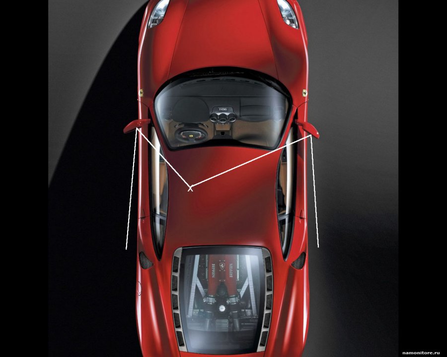

    I haven't checked my Prius, but I googled "cars from above" and quite a few have the driver side mirror angled further out than the one on the passenger side. Here's a Ferrari, for example:
    As bisco says, because the driver's seat isn't centered the mirrors have to be angled differently in order to give the same rear view. Some cars may do this by having the mirror housings at different angles, as above, while others may just change the angle of the mirror itself within the housing.

  9. ftl
    ftl Explicator
    Jun 2, 2009
    1,812
    790
    Long Island NY
    That's exactly it. Here's the Ferrari (not *my* Ferrari, unfortunately!) with lines drawn from the driver's head position (approximately) showing how the angles have to be quite different on the two mirrors in order to provide the same rear view:
