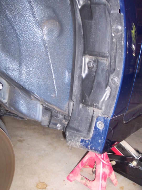

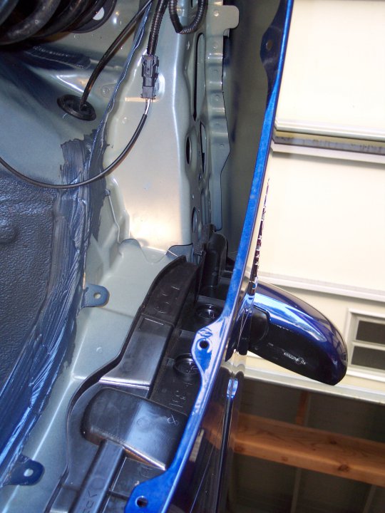

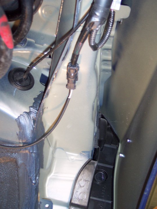

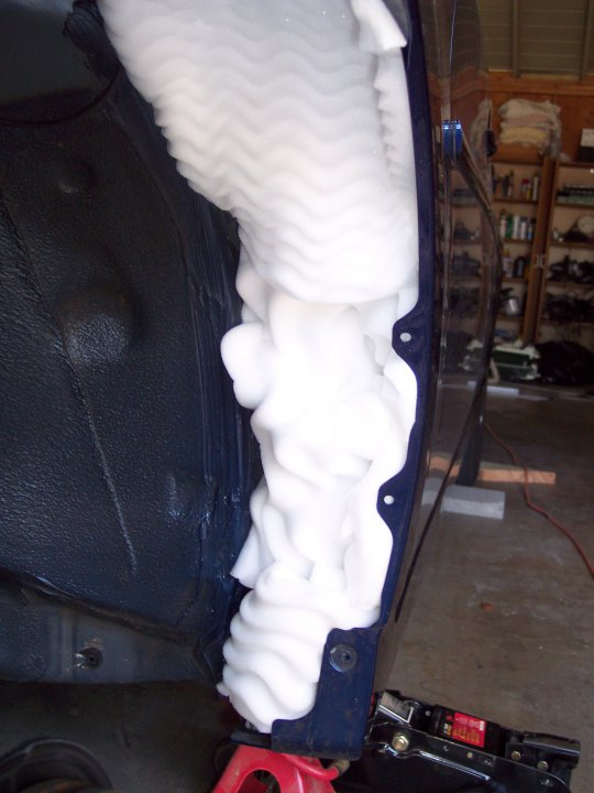

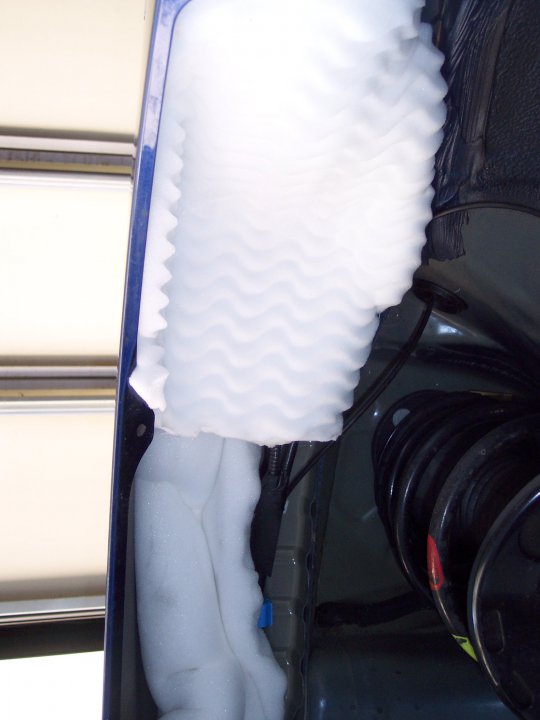

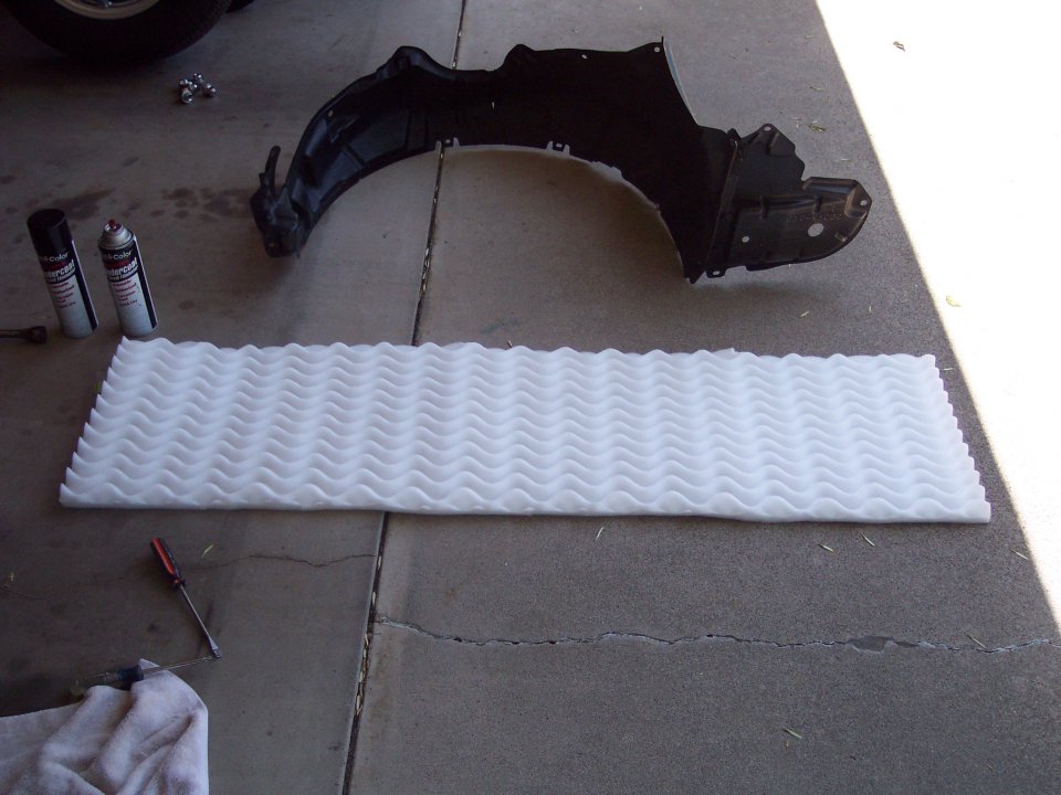

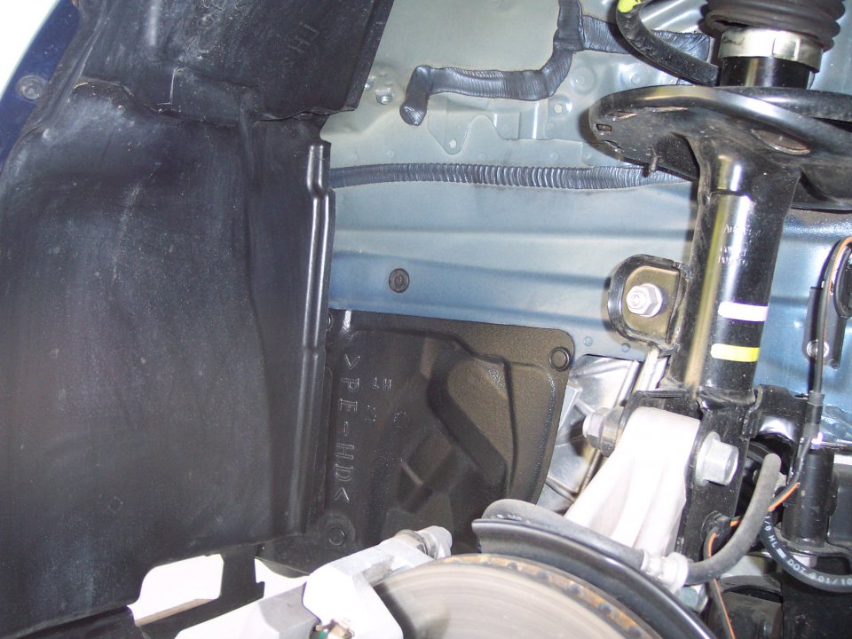

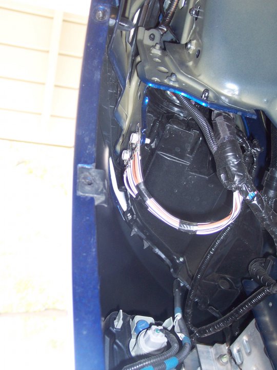

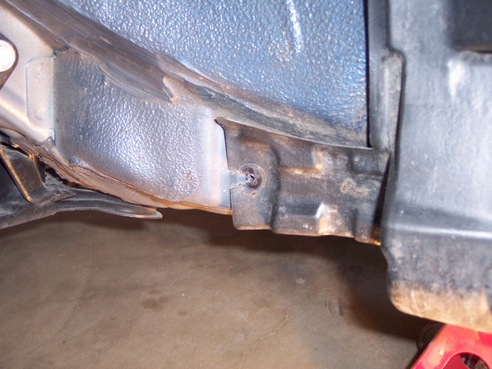

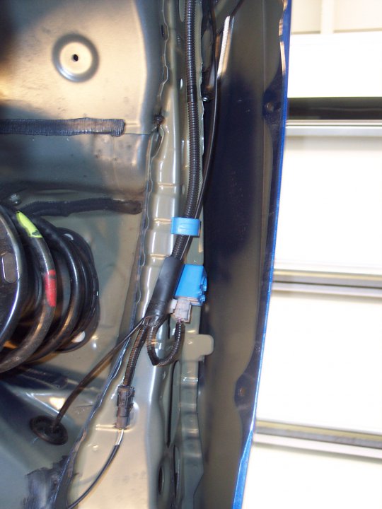

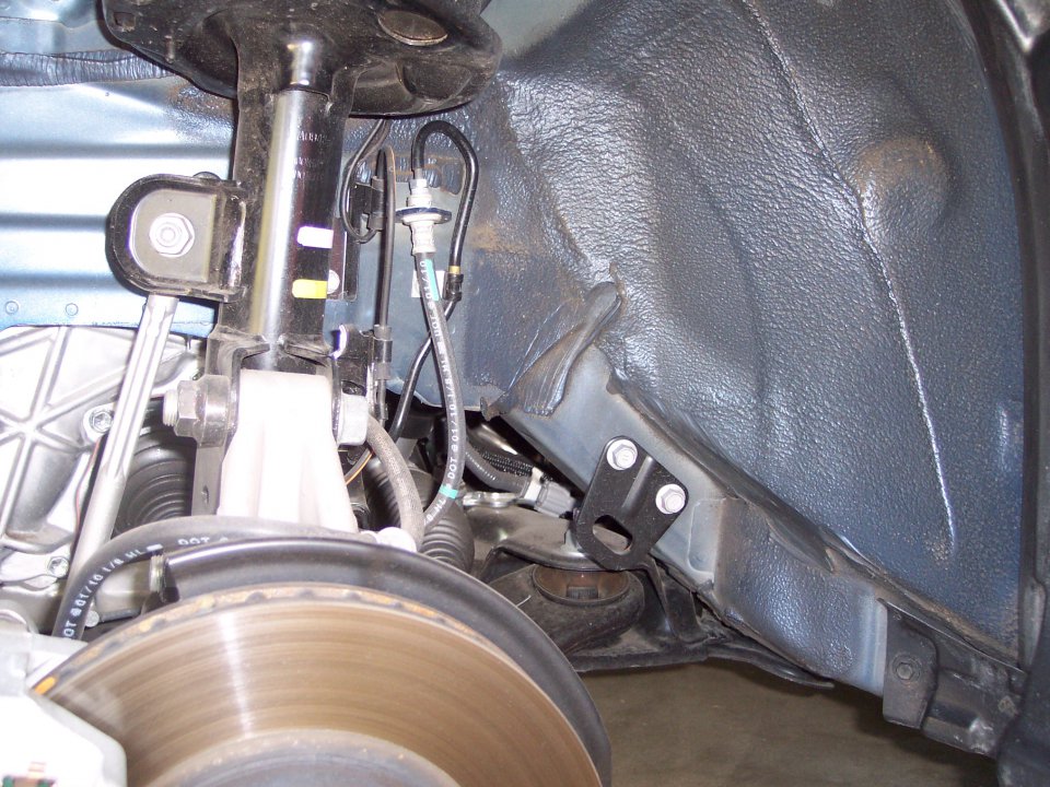

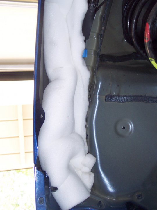

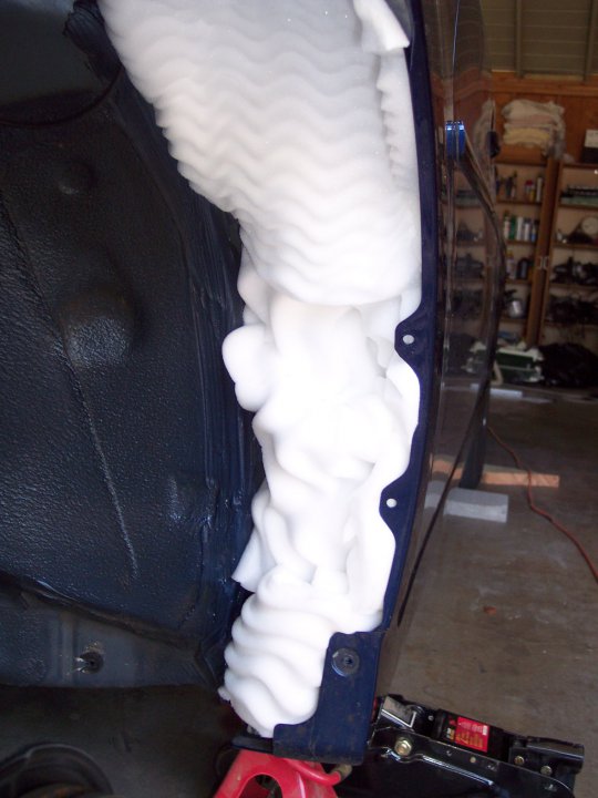

    Here are the thumbnails of my wheel well muffling project:

    I had to really cram that foam-rubber in the cavities. I put emphasis on the areas closest to the firewall. I did notice a difference, but it is subtle.

    Great. I want to research on how luxury cars get their treatment of sound deadening to pinpoint the areas that need more of what and where and how much. I've learned that to be effective, the product should be at least 1/4" thick. The areas you did are what I will do next. I will apply this along with my B-quiets.

    Yes, I did all of that and it did help some, but I'm convinced that allot of road noise at higher speeds comes thru the engine firewall and thru the struts where the top bolt is mounted to the body.

    If I remember correctly, I got all of it at Walmart near their pillows and bedding area. They have a pretty good selection of foam rubber. I just cut it to fit and jammed it in there as far as I could. I did seem to help with wheel well noise.
