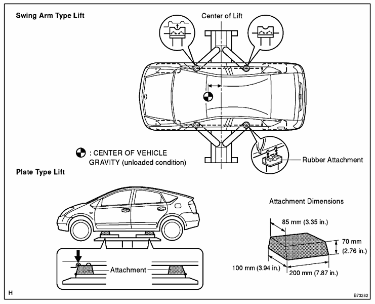

  15. hobbit
    hobbit Senior Member
    Mar 23, 2005
    4,089
    469
    Bahstahn
    The car's center of gravity is a little bit behind the inside
    rear-view mirror, maybe where that flip-down glasses case is. If
    you match your jack point there it should lift pretty evenly but
    then again the suspension travel and spring rate might be slightly
    different fore and aft.
    (from Toyota manuals)
