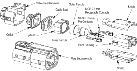

    I had noted that, but what I meant was that my wish list would be for the cables to be built using actual HV cable and connectors.
    The ones that generally come with these inverters seem to be made out of extension cord and Anderson connectors.
    The car uses shielded HV-specific cable and employs a self-testing technique to detect leakage between the HV conductors and the shields. It also has a low-voltage interlock circuit to detect when connections are open. There is HV cable available that contains both power conductors, shielding, and the low-voltage interlock circuit.
    Available HV-specific connectors ensure the integrity of the shielding, and include interlock pins to complete the circuit when connected. A touch-safe dummy connector is available to be used on the car-side pigtail and complete the interlock circuit when the inverter is not present.
    So that's what I was saying would be on my wish list.

    Our kits include HV cables and connectors rated to 300v for gen2 and 3 prius, and rated to 600v for higher voltage models. The car cable in fused. The car-side connector is suited to the vehicle.
    The connector you reference above is similar to connectors the OEMs use. But problematic to serve as an aftermarket product connector. Still, I am open to ideas.
