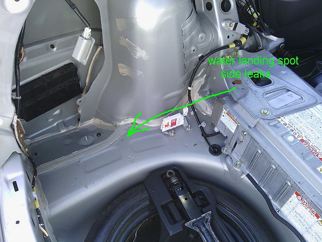

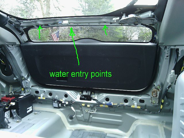

    roof area. this is the major culprit to the leak and where the water first enters the frame... through hairline cracks near the roof gutter

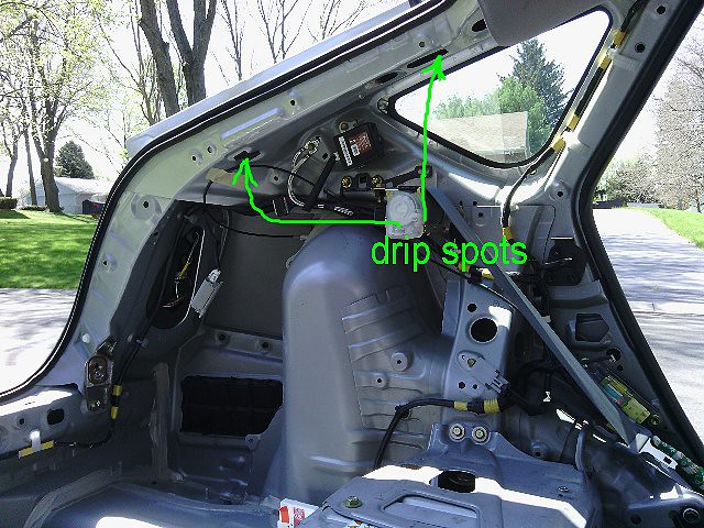

    then it drips to inside the trunk through this two main openings:
    and it drips on one or both of this two areas: on of which is on top of the hybrid battery!

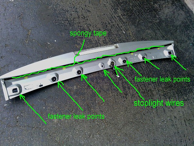

    bumper cover screws without rubber gasket or worn out

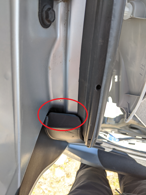

    back gate
