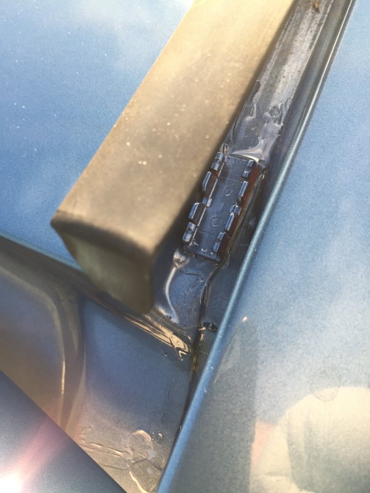

    Thanks for the detailed pictures! I knew about the roof leak, the others are a surprise!
    Leaks are fixable with caulk, I used silicone on my ‘08 Prius 2. Caulked both trim sides and no more standing water in the trunk. I treated the surface rust with Zinc spray, it stops rust and corrosion and dries fast. It leaves a light grey finish behind.

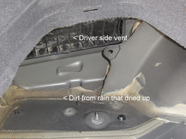

    Update since my last reply, it started leaking again. Now it’s leaking in front of the pressure vent (driver side). There was a pool of water in the vacant compartment underneath it. I was in the car when disassembling the liner, saw it dripping. Videotaped it right away. Going to hose it down soon to identify other leaky areas.
