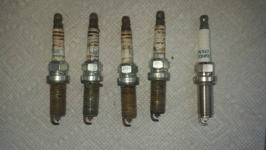

    Car is sitting it's deer hunting season so my husband is missing until tomorrow.
    I'll update as soon as he changes the spark plugs.
    If we should be looking at something else besides the spark plugs I'm all ears.
    ~Estela

    Estela13, does that car consume noticeably more engine oil than it did earlier? Keep us posted. Thanks!

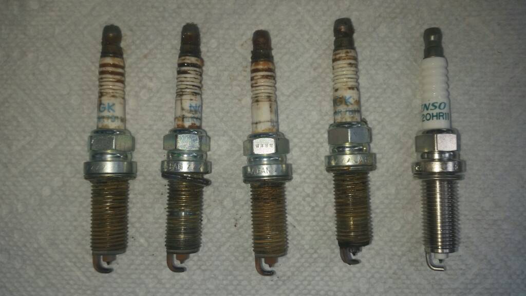

    Just finished changing the spark plugs one and a half hours later I think that solved the problem

    Yes topping off every week
    One of the plugs had black junk on our assuming oil?
    Car is running good off to work

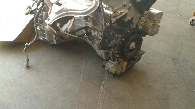

    I requested a pic of my engine just received this

    In fact, there is a leak, as you mentioned. Does the garage staff think the oil consumption comes from this?

    Haha yes... I'll ask them, they have been awesome with my requests

    No Cesar stated the engine was bad no compression

    Thank you for the information. Maybe you'll swap engine, and then if they open probably will find sticky piston rings :(
