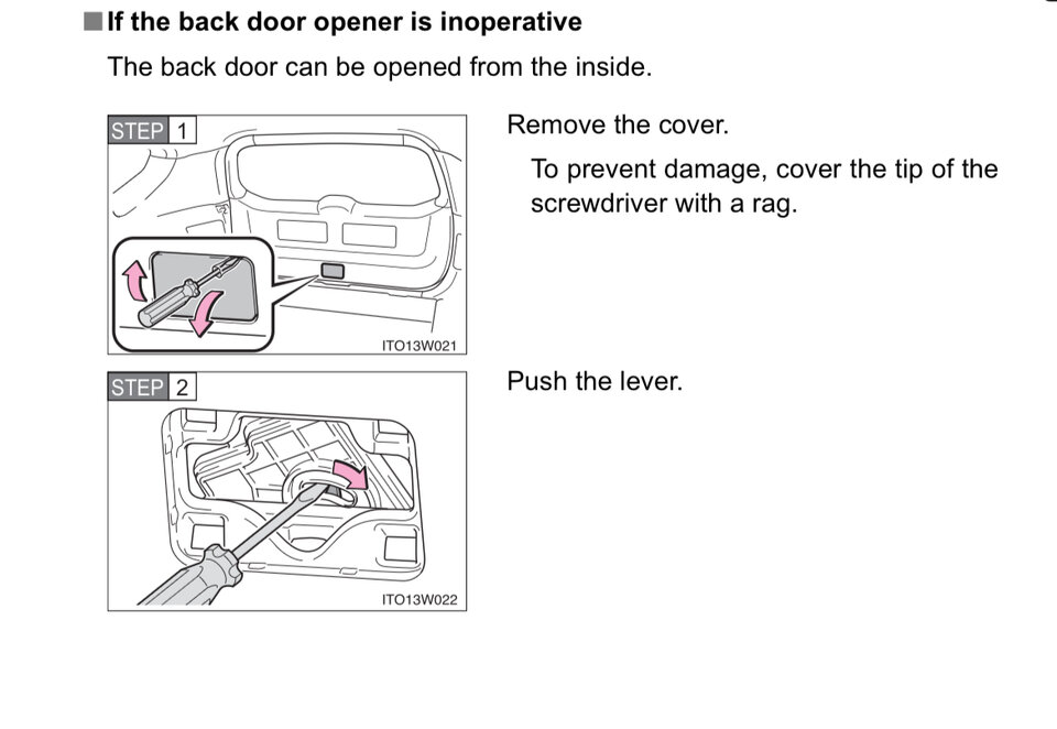

    PS: Man! Do I wish it was possible to operate the hatch by hand from inside the car!

    Flipping one of the manual lock/unlock rockers wasn't an option? Are the rear-door child safety locks applied?
    There is a large, high-voltage, traction battery, and a small, 12-volt, aux battery.
    The cycling of the engine is determined by the charge state of the traction battery. The aux battery is slowly getting charged whenever the dash says READY, whether the engine is running or not. From a full discharge of the aux battery, ten or more hours in READY can provide a full charge.
    Maybe brush up on that part of the owners' manual before the next time you might want to do that. Ought to be around page 126.
