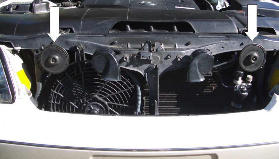

    The Hella Supertones draw more amps than most OEM horns - I added a set of German-made Supertones to a "Toyota" (Lexus LS) back in the early 90's before production of the Supertones was shifted to India. My Supertones mainly "squeaked" without a relay that triggered direct power from the battery. I actually thought the Supertones sounded too obnoxious to use and removed them but that was back when cell phones were rare and people weren't driving while texting and playing on the Internet.
    I sure recommend always using an extra relay when adding horns to ensure maximum volume and that the horn circuit is not overloaded. Maybe it was coincidence but a steering wheel horn pad on one of our cars failed within two weeks after I thought I could get away with adding extra horns without using a relay. The best price for a new replacement horn pad / air bag assembly was over $2,000 -- I was lucky to get one for about $500 from a salvage company.
    It's not on a Prius but but here is a photo showing the original Toyota horns and two extra Toyota horns I added to my daily driver using a horn relay I bought at Advance Auto and powered from a terminal on the engine compartment fusebox.
