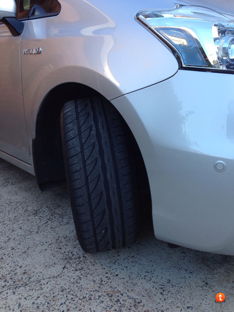

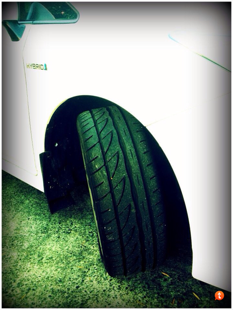

    Not wanting to affect the ride quality and ground clearance but to get rid of the nervousness of the car, I started out putting the 2010 IS250 17x8 rims on 225/50R17 Bridgestone RE002. The size is the closest to the 16" wheel diameter (approx +2mm) and doesn't look oversized. Fuel economy wise I really don't care. It's pretty efficient as it is and I care more about safety above FE. The standard Bridgestone Turanza ER33 were terrible in every way. The RE002 don't make themselves heard despite the aggressive tread pattern.
    Results is a big improvement with wheels/tyres on its own but the car is definitely under dampened as it somewhat bounces mid corner (car has done 15000km). The nervous front end has almost gone since the light steering makes the car still wander anyway. I'll put on the front under suspension brace and mid chassis brace from the famous guy here to see if it improves more.
    I do however have some OE Prius alpha 17x7 (not available to Australia) coming since the 8" wide rims technically requires engineer's certification to be roadworthy. Hopefully it won't reverse the improvements too much.
    Aside from the tyre size difference between the v/alpha to the hatch, my hatch with the exact changes (+ the chassis braces) has certainly been changed the hatch where the VSC beeps way earlier than when tyre grip is lost.
    RE002 on my Prius hatch which now I also have on my Prius v/alpha
    On the v/alpha
