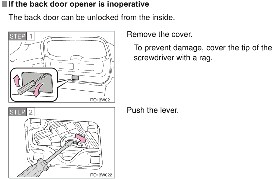

    In case anybody needs to open a v hatch without such a mod (sometimes necessary if the 12 volt battery gets discharged):
    ozjimjam and Air_Boss like this.
