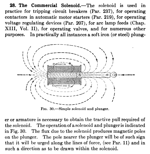

    There is no such component. What you are calling a "solenoid" here is a switched-reluctance electric motor, which rotates through cycloid reduction gearing to move the parking pawl into and out of position.
    Solenoid:
    Switched reluctance motor:
